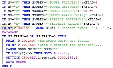

...I note that one of the SETTICK commands is still black, but the LOC and user defined subs are correct.

The cause of the second SETTICK not highlighting is the ':'
Multi-statement lines were a problem but I think you will be pleased when I get around to releasing the next beta.
