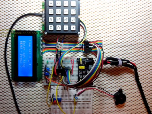

It works fine that way Rob. I'm doing that on UV lamp exposure controller now I'm working on now - code below. I just set it to 99 and loop till "keypress" returns as other than 99. I also got it to assign the 99 to another variable and convert it to a string but that's unnecessary - I just haven't changed it from some playing I was doing.
The 24 pin Pic's looking a bit cluttered too you might notice, but it's handling the standard 4x4 keypad and 4x20 LCD display fine. There's also a pin being used for a lamp relay and one for a buzzer - there's still a couple left!
You can't see it on the photo but that cursor is flashing nicely and steps through the mins/secs entry as it's done and does entry error checking too. The empty line under it has the "Countdown" on it when the lamps are ON - all very well lined up now that Geoff's given us the STR$ function with optional leading zeroes - great!
The code works fine as is but it would never pass "Programming 101" . There are a heap of "naughties" in it yet that I'd like to get rid of.

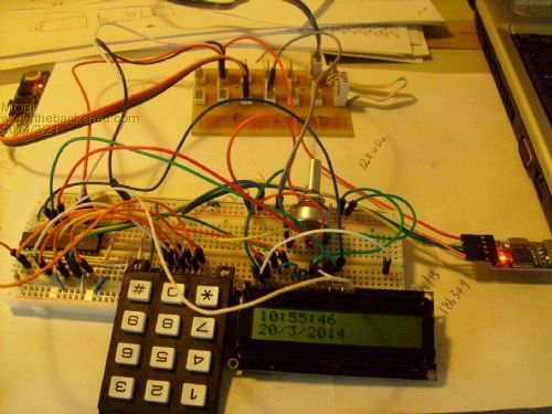

My version allows a RTC register to be selected by a 2 digit decimal number, then input a 2 digit BCD value and if the # key is pressed,(accept), the routine writes the BCD value to the register. Simple! This allows alarm values to be set as well.

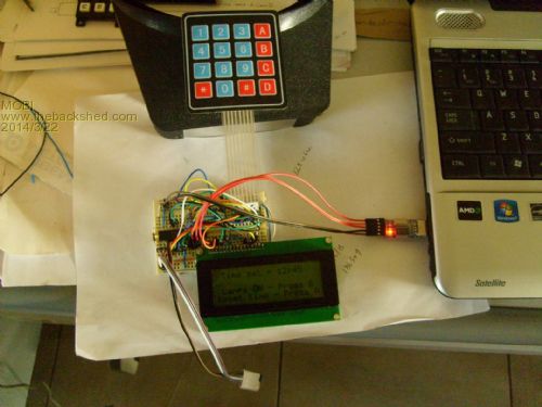

This version lets you select any RTC register and alter its value via uMite Keypad. The aim was to use uMite keypad and LCD. Frankly, I'd prefer i2c LCD unless using the 44 pin Pic as not too many I/O pins are left for outside world control.
It doesn't have "time-out" facilities but that wouldn't be hard to include. As it stands, it is little more than a clock but once again, individual applications are easily enough programmed in. The main part is the ability to select and change individual registers.

Yes it's for a collimated UV lamp box to expose resist coated PCB's - I'm hoping to get good enough resolution to do the 40 pin 0.4mm pitch pads for the flex connector socket for the 5" TFT Maximite screens - time will tell!
It could be the length of the SETTICK interrupt routine but that's only called once a second. The problem is it's also looping waiting for any STOP keypad presses in the meantime while it's counting the seconds down.
I'll keep chasing it but I want to get onto doing the box - I've got all the bits here now.

@ Greg,
As you can see, I got the jungle running - not pretty but it works.
I got your programme in and yes, it does do a few quirky things and hangs up/ bombs out etc.
I had never heard of the TRF foil. It look like the cat's whisker for fine PCB traces. Pity my laser mono is a Brother and the toner will not iron onto blank PCB no how. Never mind, Kinsten, NaOH developer, and HCl H2O2 etchant works for me - no "big bangs" here so far.
Now, on to the programme...
David M.

Posted: 12:13pm 22 Mar 2014
  Greg said  Oh come on David, be kind. My description would be "generally works OK" but has a couple of quirks
Sorry, It does sound a bit harsh. Actually, I think your programme is "nearly there" and I do like the neat way you enter the minutes and seconds.
  Quote  Do you know exactly what concentrations of HCl and H2O2 your etchant ingredients were before mixing - and the mixing ratio and supplier. If you do it'd be worth mentioning that in the other thread.
The HCl is 30%(same as builders use for cleaning concrete) and the H2O2 is 3% (off the shelf from the supermarket).
I think Downwind did an article on TBS on making PCBs and may have included the concentration and mixing ratio. If I can't find it on TBS, I have it in an obscure folder on the PC somewhere.
I checked my archives and the ratio is two parts H2O2 to one part HCl. (add the HCl to the H2O2)
