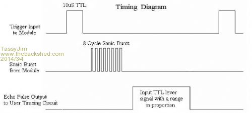

You should be seeing a 10uS pulse on the trigger terminal followed by a variable length pulse on the echo terminal.
Can you see if there is a burst of 40kHz on the transducer?
It looks like you might have a faulty unit.

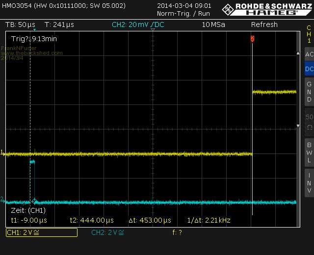

Hmmm, is it possible that the timeout of our new range command is to short?
I can see the trigger signal with 10µs and the echo AFTER 453µs!!!
I have found in two manuals that the echo should have a delay of about 250µs!
Blue is trigger, yellow is echo:
The µMite says exact in this moment "no response"!
Frank

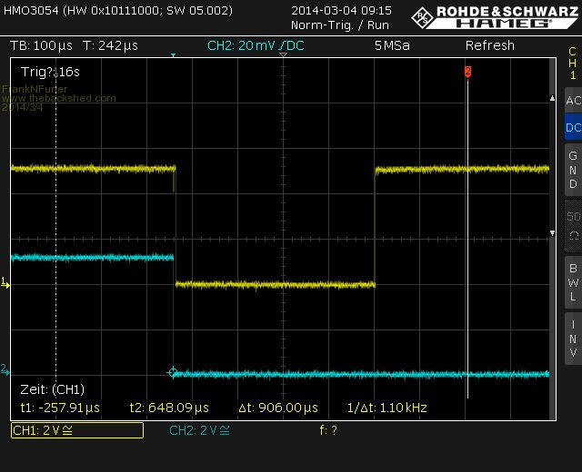

But the signals are very curious:
trigger is blue, echo is yellow, but trigger is high (no 10µs pulse) and echo is also high!

can I see that the sensor works all the time without any problem...

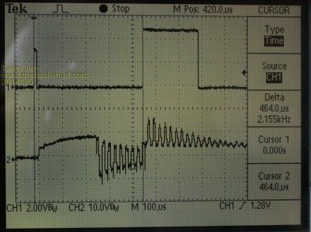

My sensor is 3 terminal so Trigger and Echo are combined on the top trace.
The lower trace is from the Tx transducer.
This was with a range of about 50mm
Colour hadn't been invented when I purchased my CRO.
