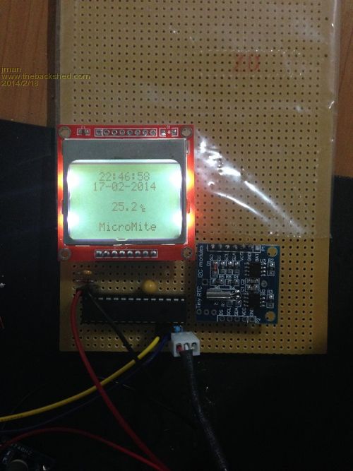

Ok so it seems the Nokia 5110 LCD has drawn a little attention
This are driven by the SPI interface
They are completely graphic displays (No built in fonts)
But his means we can make our own cool fonts and pictures
In my previous I made an error the resolution is 84x48
They are 3.3v so perfect for the UMite. add a 47ohm resistor in
series with the backlight
Attached is the code I used for Clock / Temp display in the Pic.
With the Maximite I normally load the fonts from the SD
The little board in the picture has a DS1307 and 24c32 eeprom I have also
used the eeprom to store the fonts. The attached listing has the fonts
in the main program
2014-02-18_072256_Nokia5110Clock.zip
Take a look at the listing the fonts are near the bottom.
There a few utility's that will convert BMP's to Hex codes
I will dig them out and post them
Jman

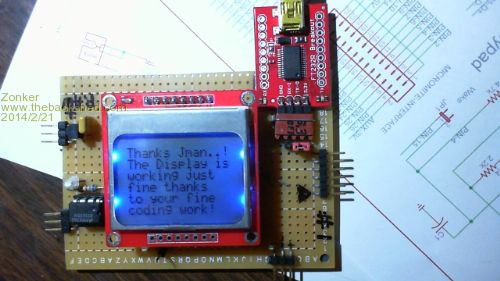

One Picture says it all..!!
Awesome display for the uMite..!

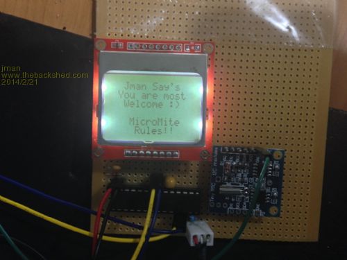

I could not resist

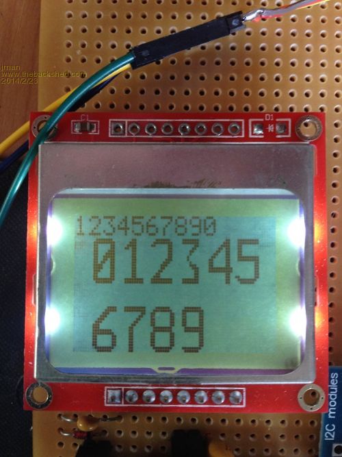

@ Paul
Is this what you are after
