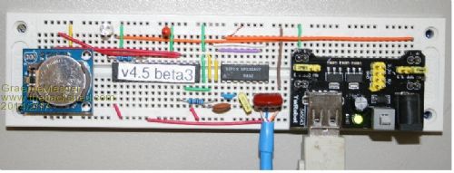

Hope someone can see the error of my ways. I am trying to set and read the RTC on a I2C 1307 module with the Micromite.
The module and original code supplied by Jman in 2011 works perfectly on the CGMMSTICK1 and the Olimex Diunomite Mini both running MMBASIC version 4 but I cannot get the result from the Micromite running Version 4.5 beta.
Hope someone on the forum can shed some light on my problem.

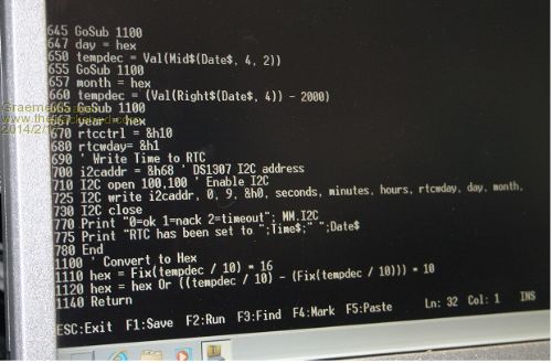

The code I am using is:
' Original Program for getting time and date from external RTC
' Presented by Jman 07/2011 on TBS altered for the Micromite V4.5beta3
600 ' Get time from time$ and date$
610 tempdec = Val(Left$(Time$, 2))
615 GoSub 1100
617 hours = hex
620 tempdec = Val(Mid$(Time$, 4, 2))
625 GoSub 1100
627 minutes = hex
630 tempdec = Val(Right$(Time$, 2))
635 GoSub 1100
637 seconds = hex
640 tempdec = Val(Left$(Date$, 2))
645 GoSub 1100
647 day = hex
650 tempdec = Val(Mid$(Date$, 4, 2))
655 GoSub 1100
657 month = hex
660 tempdec = (Val(Right$(Date$, 4)) - 2000)
665 GoSub 1100
667 year = hex
670 rtcctrl = &h10
680 rtcwday= &h1
690 ' Write Time to RTC
700 i2caddr = &h68 ' DS1307 I2C address
710 I2C open 100,100 ' Enable I2C
725 I2C write i2caddr, 0, 9, &h0, seconds, minutes, hours, rtcwday, day, month,
730 I2C close
770 Print "0=ok 1=nack 2=timeout"; MM.I2C
775 Print "RTC has been set to ";Time$;" ";Date$
780 End
1100 ' Convert to Hex
1110 hex = Fix(tempdec / 10) * 16
1120 hex = hex Or ((tempdec / 10) - (Fix(tempdec / 10))) * 10
1140 Return
Hope I got it all
I have tried pullup resistors from 4K7-20K with no change.

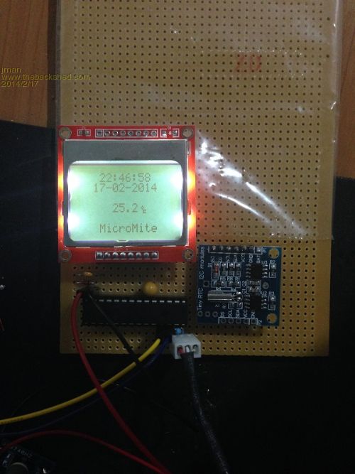

And a little Picture of it going
JmanEdited by jman 2014-02-18

hey Jman...
What kind of display are you using there..? Is it an IIC device also..? How do you talk to it..?
Thanks for any info..!
jman
Joined: 12/06/2011
Posts: 711
Posted: 08:19am 17 Feb 2014
  Zonker said   hey Jman...
Hi
The display is a Nokia 5110 LCD. They are pretty cheap from Ebay
Nokia 5110
they display has an SPI interface so pretty easy to talk to
these display's are 84x84 pixels with NO built in fonts. The cool thing
is you can make custom graphics real easy (Like my degree symbol)
I can post my code if you are interested ?
Jman

Jman are you using beta 3?
This code still returns MM.I2C=1

What voltage are you running the DS1307 on?
It needs 5V.
OA47
Joined: 11/04/2012
Posts: 1065
Posted: 12:08pm 17 Feb 2014
  TassyJim said
It needs 5V.
Jim, you cracked it. The extra 1.7v made all the difference.
Thanks for your assistance and the other Shedders for their help.
