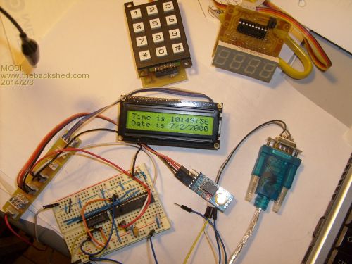

Here I go banging on about i2c again. I just thought I'd start a thread so members can share how they use I2C.
This is just an example. I took Geoff's i2c RTC example for Maxi/Mini and displayed the time and date to a LCD. Plug in the Keypad and use it to change the date/time settings or drive a menu or with a data expander, manually or automatically switch relays etc. The Chinese RTC shown also has temperature readings available plus a pad for a eeprom.

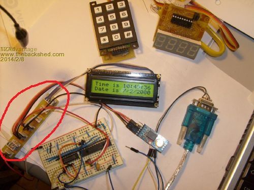

Is that a powered i2c 'hub'?

Hi TZA, yes. The i2c bus board (4 pin headers) is fed with either 5vdc or 3.3vdc from a small LM317 power supply fed from a 5vdc switch mode plug pack.

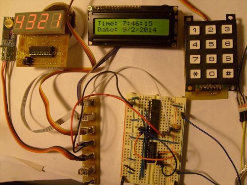

If anyone wants a play.
@Grogster, we are in the right year now. The test set up is essentially a clock running in a loop. The keypad is polled at the top of the loop and drops out to a menu subroutine to alter the registers then back into the loop.
Plus example firmware in zip. If you are using your own i2c modules, addresses and formats may change a bit.
