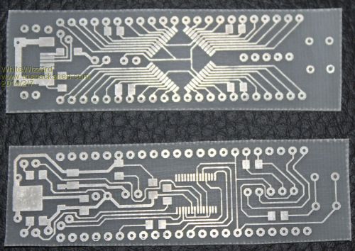

Update:
Below are the two boards making up the double sided PCB.
Ignore the rough cut - I will file this down, and round the corners, once boards attached to each other.
Only one short detected on FTDI chip (bottom board).
Will update picture once boards attached

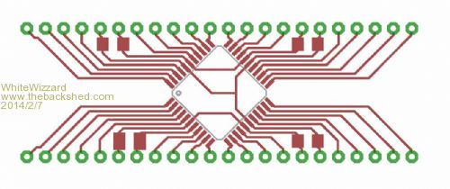

Thanks for everyones feedback. In response to Rob and Lou, my original idea was for a very simple single sided PCB comprising with just the TQFP and caps - creating basically a 44 Pin DIP to plug into a breadboard (see below).
This basically becomes as easy to use as the 28 Pin PICs but with all the extra pins of the TQFP package.
If anyone is interested, I will gladly provide the Gerber files for this PCB for people to make at home.

I'd be very interested in the Gerber for this.
What size SMD caps are you using?
1206's?
Apart from the 47uF cap on pins 6 and 7, the others are 100n PSU filter caps I guess?

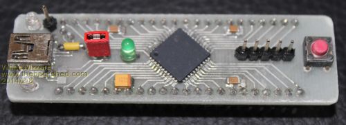

Prototype now finished .
Loaded HEX file and everything worked first time (I really like this about all of Geoff's projects!)
Top:
ALL 44 pins brought out to the two rows of header pins. Pin 1 bottom left, then anticlockwise to pin44 on top left (Identical to a DIP)
Tx Led (top left)
Mini USB (COMS and/or 5v power in)
Rx Led (bottom left)
Single Pin next to Tx Led = USB 5v output
Red Jumper = Disconnects 5v USB power from circuit (i.e. on/off switch)
Green LED = 3v3 Power (from onboard dedicated reg)
47uF tant below green Led
ICSP 5-pins
Reset Switch (keeps Tera Term connection open while reseting PIC only)
Note the positions of the reset switch and ICSP mean that you cannot connect a PicKit3 the wrong way round (Come on - we've all done it at some time! )
I've included 3x0.1uF decoupling caps to eliminate any issues (even though the 28 Pin PIC worked ok without them)

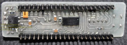

Bottom:
3v3 Dedicated 1A LDO (LF33) (left)
FT232RL USB-to -UART (centre)

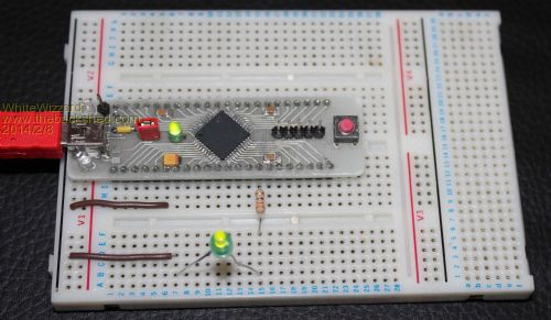

And here it is in operation. Doing the usual thing first - blinking an LED.
Note this is on Pin 15 - no issues
Also to confirm that there are three available breadboard holes either side of the module (angle of photo clearly shows this on the bottom row)

Nice board WhiteWizzard. I am interested in Gerbers for both single and double sided boards, perfect protoboards for the 44-pin chip.
MicroChip specs a 10uF low series resistance (1ohm) for VCap. I have been using a 22uF tantalum for VCap and one .1uF on pins 27 and 28 on the uMite 28 boards without problems. For regulators I'm using 78L05 for 5v and MCP1702 for 3.3v, both are LDO.

A fine job Phil. I find it very hard to fault as it seems to tick all the boxes.
Just a couple of items.
A single pin for +5V out? It would be good if you can squeeze a GND pin beside it, rather than the user chase the appropriate GND pin on the 44 pin DIP device, or elsewhere on the board.
I assume it could be used for 5V in, or 5V out?
A 5 pin PIC ICSP header?
