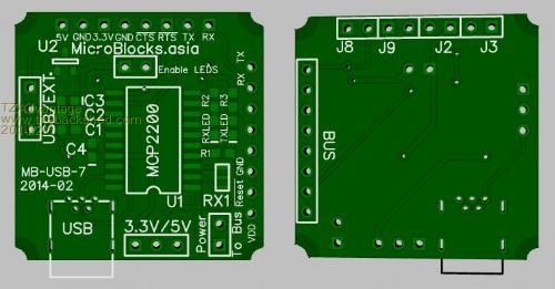

I have made a new design of a USB-UART based on the MCP2200.
This one is MSL-1, so no 'popcorn'. :)
It has a selectable powersource, 3.3v or 5v operation, leds for RX and TX, plugs into a breadboard and also in my own MicroBlocks BUS for using other serial ports.
The pcb is 30x30mm. I purposefully left out a reverse voltage protection because of the voltage drop and because it is a USB to UART and not a power supply board. With some 'tricks' using the jumpers the power can be routed wherever you want it, but in practice it will probably use USB power. It can directly feed a uMite with 3.3v as it has an onboard voltage regulator.
What do you think?

hmm where a much really cheap devices out , but run this board without a driver ,when its really cool.
Posts: 10048
Posted: 01:43pm 05 Feb 2014
I kinda like this more then the $2 cables you can buy, because it is probably a better design, as I have had many issues with those Prolific "Clone" cables - I prefer a proven design over just what is the rock-bottom cheapest.
I'd be interested in some of these, TZA, as I was going to design something like this myself, but now I probably don't need to, and it is nice and small, so I could just add it to my main PCB as an add-on module. I also like blinky lights on things, so the LED's work for me!
Gimmie a PM about this with prices and availability please.(or post it here, if you are happy to make it public)

Most of the other 'cable' ones are configured for plugging straight into the computer's USB port. Another option of a small board to be placed on the breadboard or final project instead, is a good idea - everyone will have a standard cable to connect it with.
One question though TZ, why not use the more powerful (bigger buffer etc.) and configurable FT234XD chip like Zonker is putting in his 'development' board.
Greg
Edit: Think I'm getting confused here TZ; you already answered that before in Zonker's thread. I'd missed that it was the same chip

That is an interesting design.
Microchip has one with a built in 3.3v regulator so there is more power for the MicroMite to be powered directly.
The schematic and board layout are in the user manual.
http://ww1.microchip.com/downloads/en/DeviceDoc/52064A.pdf
They have completed modules but looks like they are out of stock until March.

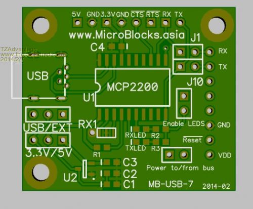

Here is the USB-UART:

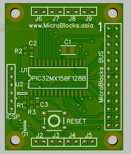

And here the pic32mx150f128b wired as a uMite:
The bottom lines up with the top of the USB-UART.
As the uMite has a specific pinout because of the configurable pins i will have to check if that falls under a copyright and under which copyright uMita basic will be i will have to check with Geoff as i have plans to sell these.

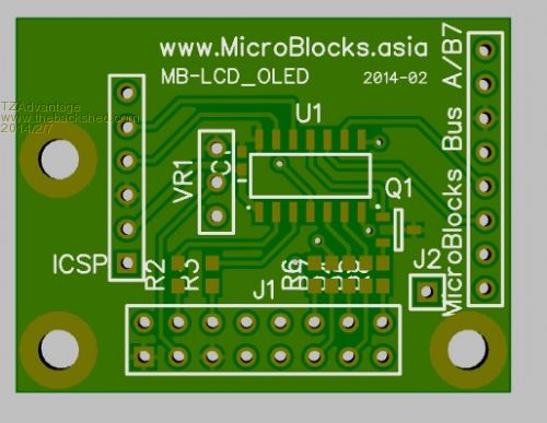

And here is the LCD that is connected through I2C, code by MOBI!
I have to go over these a few more times to catch any mistakes, then of to the pcb maker for some prototypes.
