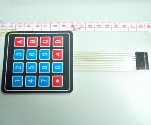

Hi All,
Did a bit of digging in the forum and could not find any info or code to read and effectively use a 4 x 4 matrix key pad like the typical one attached (picture). This is a 4 row and 4 column matrix, basically using 8 I/O pins. I did find the matrix keyboard to analog pin circuit and code, but does anyone know of some good code to scan and read one of these using the digital pins instead? I would like to interface one of these to micromite and would appreciate any info one may have. Maybe using a tick interrupt routine? Thanks to all!!!

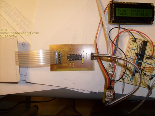

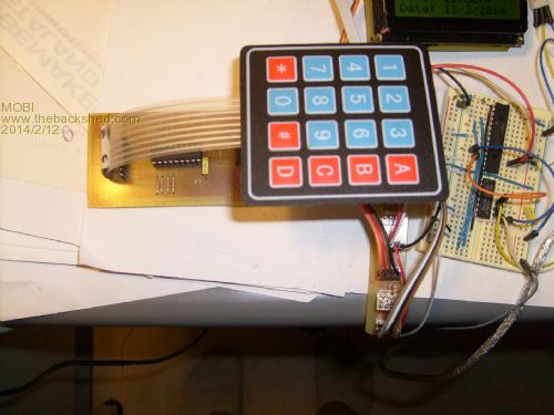

Some years ago, I did a I2C version of this same (or at least very similar) key pad.
The first one I did was for a 12 key unit (4x3) but as there were spare pins on the pic, I did a 4x4 version. I thought I posted it on TBS but maybe not the code? Don't remember, but I am more than happy to re-hash it and provide the cct diag and source/hex code. It was for the PIC16F88/819 chips.

  Quote  I am trying to use just the micromite to read the keypad (using 8 pins) and run a 4 bit lcd (2004) (using 6 pins). This will still leave 7 I/O pins to use for other things
I understand. Scanning the keypad wasn't difficult. All I did was cycle a "1" through the 4 outputs and read the inputs which gave me a 16 bit count.
There were two options for key value. One was a key number from 1 to 16 and the other was to feed the key value to an array which contained the ascii key values or what ever you like.
Personally, I think it is a lot of wiring which can be reduced to 2 wires using I2C which the MM and microMite (uMite still in beta) do very well. The other thing about I2C is that the coding is very simple, besides, you can "plug and play" additional modules.

You would set up a matrix like this:
R1 ----- x -- x -- x -- x
R2 ----- x -- x -- x -- x
R3 ----- x -- x -- x -- x
R4 ----- x -- x -- x -- x
C1 C2 C3 C4
Connect each button to the row and column at the x. If you have a ready made keypad the chances are it will be wired like this, you can check with a multimeter. Set pins R1 to R4 as outputs, and C1 to C4 as inputs. Now periodically set each Row pin to high and see whether any column inputs are high.
I am not sure whether mmbasic supports this but I would try this: create an interrupt routine when any pin c1 to c4 goes high. Then make all row outputs high. Now whenever any key gets pressed the interrupt will get called, and you can quickly change the row outputs to determine which row was pressed. This would eliminate the need for regular polling.

  Quote  Wouldn't you have to scan the keyboard with the I2C the same way you would with the micromite, just using an additional pic?
Yes and no. The pic attached to the key pad does all the work i.e. scanning and code production. It is an I2C slave and to access the key pressed information (get a key value), one only needs to issue a single i2c instruction to the i2c bus from say, a MaxiMite and the key pad will respond with the key data.
e.g.
i2c read kpad,0,3,0,key,control
Where kpad is the i2c address of the key pad, key is the key value and control is a handshake byte
