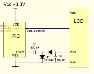

Hi All
Playing with the new MicroMite I wanted to drive a 4x20 lcd
After a quick look at the LCD datasheet the supply voltage range is
2.7 to 5.5 so no problem there.
The problem is with the supply at 3.3v the contrast pin needs a negative
voltage.

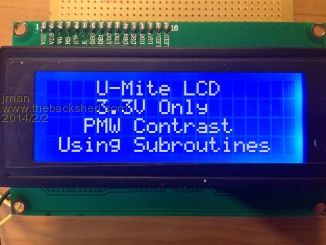

I used a PMW output and this simple circuit and now we have software adjustable
contrast with 3.3v only. I have attached the modified LCD program
You can use 1n4148's in place of the Bat54s's

I am not a popular poster around, but from own experience I believe this circuit is a bit pointless and can be significantly optimised. The negative contrast voltage is relative to the power supply and is internally generated.
From outside you can do variable contrast by simply connecting Vlcd through 1k (typically) resistor in series to a PWM output. Usually in the devices the LCD contrast is fixed (with 1k to ground) and the backlight is PWM controlled.

Well, yeah, the common method I have seen, is to connect a 1K trimpot between VLCD and ground. You just twiddle the trimpot to get the best contrast - set it, and forget it.

  kiiid said   I am not a popular poster around, but from own experience I believe this circuit is a bit pointless and can be significantly optimised. The negative contrast voltage is relative to the power supply and is internally generated.
Hmm I don't think so
With +5V Vcc the Vlcd can be obtained from the same +5V Vcc voltage by using a resistor voltage divider or a pot, while with +3.3V Vcc this requires a negative voltage source (from 3.3V-5.5v=-0.2V to 3.3V-5V=-1.7V).
