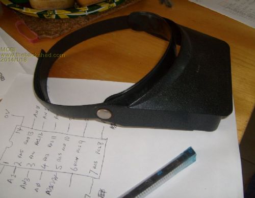

My eye sight has long deteriorated to the point that reading glasses are no good either, but these dual lens stereo vision magnifiers are a wonder. Without them, I would have given up long ago.
They don't need batteries and are only a few dollars at the cheap shops.
