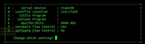

The PC sees the Duino (ttyACM0) but I get no screen and an error
(on terminal) 'can't open ttyACM0'
What should be settings on serial setup ?

1)installed Minicom via dpkg
no errors shown
2)followed this (from Duinomite users manual)
(except installed minicom via usbdrive with
dpkg since I have no internet on target PC):
LINUX:
If you use Linux the DuinoMite drivers will be
automatically recognized and installed.
Open console and install minicom terminal program.
$ sudo apt-get install minicom
Then you should locate which virtual communication
port is DuinoMite by running this command:.
$ dmesg | grep tty
You will see cdc_acm driver something like:
[103473.694556] cdc_acm 5-1:1.0: ttyACM0: USB ACM device
Please remember ttyACM0: as you have to setup minicom to use it:
$ minicom -s
Setup the serial port to ttyACM0: and you will see the greet message:
MaxiMite BASIC Version x.xx
Copyright 2011, Geoff Graham
Olimex Port By kenseglerdesigns.com
Everything seems right except no 'greet message'
instead 'cannot open ttyACM0' message
Edited by hitsware 2013-12-06

Mate the devices in linux are
/dev/ttyUSB0
/dev/ttyACM0
Linux needs the /dev
Its not like windows "COM1"
try "stty -F /dev/ttyACM0"

That helped .... got 'permission denied'
If I use
sudo minicom -s
then save the settings as 'duinomite'
(I wasn't saving before)
it works ... I guess 'sudo' supercedes
the needed 'permissions'?
So now how do I use 'duinomite' to not
have to go through the whole setup each
session ?

By using sudo to run minicom you are running it as a superuser/root user instead of your normal user. Since it works running as root you have a permissions problem, I suspect with /dev/ttyACM0. Navigate to /dev/ttyACM0 with your file manager, right click on it and select properties from the menu. Go to the permissions tab and see what group it belongs to. You then need to make sure your normal user account is a member of the same group.
Hope that helps, Greg.
