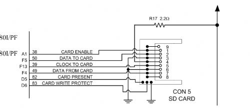

If you can use a multi meter to buzz out the connections to the SD card use this schematic to check the pins on the SD card to the PIC chip itself.
Also make sure there are no shorts between pins..
Areas I would suspect are the GND connections to the SD and its case and PIC pin 82 (card present).
Also, even though the SD card routines are MUCH better then the original MM release there are still some brands/batches of SD that do not work for some odd reason... Were the SD cards all different brands?
EDIT*** You can also try shorting out the 2R2 ohm resistor with a wire link as that can affect some cards.

You can check the SD socket insert switch by instering the SD card and checking that Pin 82 of the PIC32 is connected to GND. Same as the Write Protect switch and Pin 83.

Hi Mick,
I have checked the connections according to your schematic.
There were:
- no shorts between conductors
- all conductors ended where they should
- "card present" had ground whether card was inserted or not
- "card write protect" had ground when card was WP
- I shortened the 2R2 resistor
After checking and powering the MM it showed "no card present" when card was inserted and "files" command input. When I switched the WP switch on the card to "WP" I could suddenly read the directory.
I the powered down and back up again and had the same "SD card not found" error as before and it didn't go away since .
To shorten things I have ordered a new MM kit without display (THAT works) and will see if this one has the same symptoms.
Thanks anyway a lot for your help !!!

Card Present Should not have a GND connection when no card inserted... It sort of looks like the SD socket is `dicky' I am starting to think that some solder may have entered the body of the SD socket when soldering it and it affected the Card present switch and maybe upset the alignment of the fingers of the socket to the SD card...

Another thought, if you are handy with a soldering iron - which I suspect you are, if you have another SD socket (or you sacrifice a cheapo SD card reader for one) and solder short wires to the socket down to the PCB (rear of the socket on the PCB) and dont forget to put a GND wire to the case of the SD socket and use it to test again.
Further thoughts...
You said CP had GND whether the card was inserted or not...
How did you measure this?
ie. At the PIC pin82? or the rear of the SD socket?
With a Multimeter, in OHMS range and CMM powered off, or in VOLTS range or a CRO/Logic probe?
I ask because it SHOULD be a HARD physical connection to GND to pin 82 of the pic ONLY when the SD card is present..
If, for instance, you used the Volts range of the meter and there was a break between Pic pin 82 and the SD socket and you did the measurement at the SD socket you would not see the internal HIGH from the `weak' internal pullups.
