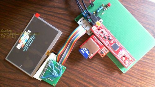

Several months back, Bovist got a special version of MM Basic modified so that you could connect it to LCD Display modules instead of a VGA screen, and added in touch control as well. (awesome!) Jman was one of the first to get a 5" Innolux A050-33 LCD touch display unit working with a UBW32 as the MM engine. Since I had a UBW32, I thought, this is the project for me... I had an idea to prototype up an EIS system, and this combination UI would save me more than half the cost of using a touch display from 4-D systems. Thanks to lots of help from Jman, I managed to get one booted up and working. The Things I was asking about are from the "TFT" version of the firmware, and are in the PDF manual of new LCD commands...
I think this subsystem is an awesome addition to the MM project as a whole and quite useful for many projects out there... Next, I think I will try to find my PICkit-3 and download the version of firmware that includes the replacement bootloader and try the demo code examples again... More info:

Just an update. Dave wanted to know how to gather the things to build one.. Well, I found the same 5" display that Jman was testing out from of all places, Amazon.com. They sell them as replacement screens for phones I think.. Got 2 for about $50.. not to bad.. I wanted to tame down the 40 pins coming out of the display to just the 16 wires needed to drive the interface before heading off to the UBW32, so I got a 40 pin display interface board from Newheaven display. They offer several types of boards that should work ok. I got the NHD FFC40 board. If you follow the posts from Bovist, he points to a place on GitHub that has download firmware and doc's... Also, Geoff has a website (mentioned above) that has information also.
I started with the "Bovist_mm_hex.hex" file loading over the USB port. After adding an extra wire I had somehow left out, I got the basic unit booting. After going over a few of the demo programs, I noticed that many of them were producing syntax errors when trying to run them. After playing around with the example code awhile, I found out how to redo the statements to avoid the syntax errors. Now, to follow this, you will have to read the PDT doc's on the LCD commands, but lets pick one of the commands used to create an active object on the screen.

Sorry about the late response, been away for a couple... I think the first thing to do is check out you display interface to see if it matches up with the group of units that have been proven to work ok.. When I read that Jman had gotten a 5" display (InnoLux A050-33-TT-01) working, I went for that one because, I figure, the bigger, the better... So, If you got a 5.5".. well... I want to be checking it out too..!! Could you post some PDF doc's about it..? Anyway, the next thing is deciding what type of display interface to use. I ended up using a converter board from Newhaven Displays. That way, I got to reduce the number of wires to 16, then just run them over to the prototype board where the UBW32 sits using a standard 16 pin IDC connector. The information about the schematic is at GitHub... Look for the post from Bovist about the announcement of the TFT Maximite. The new updated code should be there also... You will need the version 1.3 drawings, and also the UBW32 drawings to get started putting things together.. For mine, I left off the keyboard interface and do the small editing thru the USB port using TeraTerm. Also get a download of MM-Edit. This helps with doing the larger editing tasks... So, you said you got your display at Segor..? Humm, did you know that they are offering pre-built Bovist designed LCD panels ready to go..? I tried to order one, but can't seem to get past the order info section. I don't speak German, so I tried using a translator, but it doesn't work with there website very well... (bummer)... So, it would be easer to just order one ready made than spend the time building up a proto.. If you do end up ordering one from Segor, could you get one too..!! I could Pay-Pal you the money..
