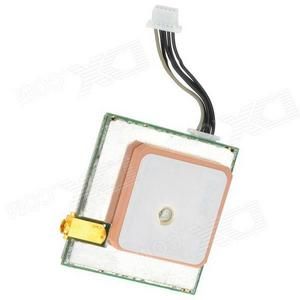

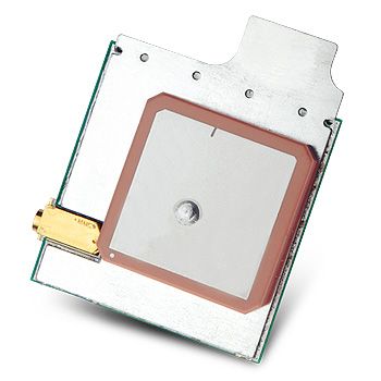

The only way that you can tell the difference is by physically looking at the module. The TTL version has the shield extended over the connector as shown in this photo:
The RS-232 version does not have this feature as shown in this photo:
The documentation only refers to the TTL version and when you are ordering one of these modules you have no assurance of what one you are going to receive as the part numbers (EM-408) are the same.
It is incredible that a manufacturer would create such confusion in the market place and unfortunately their crime is compounded by the dreadful documentation that they supply.

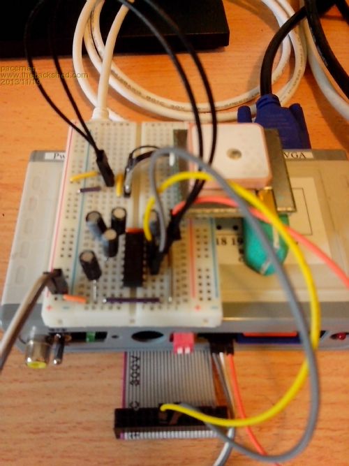

Using the Max232 type converters is straight forward but they do need five support 1uF electrolytics and typically they use a 5v supply - this bulks things up a bit. Mine looks like below:
The 'generic' I used (Intersil HIN232 CP) says 0.1 or 1.0uF caps can be used but they need to be polarized. I'm not sure whether tantalums would also be OK but if they are then the bulk could be minimized - along with using an SMD version of the 232's.
