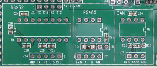

1) What kind of board is compatible with that MMBasic+CAN version ? Only Duinomite Mega or can i use a Color Maximite + some extra CAN hardware instead ?
CGCOLORMAX2 plus a CAN chip. The CAN circuit is on the board just waiting for a chip and connections to a bus.

CircuitGizmos - cool ! What chip is that ? I supposed the CGCOLORMAX2+CAN chip is supported by the MMBASIC 4.x CAN firmware out of the box - right ?
Thanks.

Specific chips are mentioned in the FAQ section of the Beginning Maximite doc. You need to flash the CAN version of the firmware onto the Colormax2.
