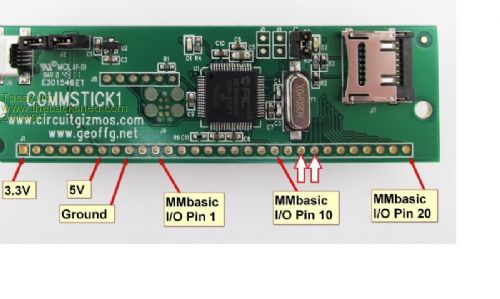

I've been away for a few months. I'm so far behind I'm just now starting to play with my CGMMSTICK1's. Time for me to move forward from the original MM. I have a nice CG color MM too, but I need to know how to connect up a RTC PCF8563 to the CGMMSTICK1.
On the original MM I connect this I2C RTC through I/O's #12 & 13 plus 3V & Grnd. I put the SDA through 12 and the SCL on 13. This configuration does not work on the CGMMStick1. I don't have a sheet for the CGMMSTICK1 and don't see a working link on the website to get one, but I think the MMIDE3 shows I/O's 15 & 16 are for sending and receiving data?
I've tried these I/O's and others and cannot get the Clocread.bas & clockset.bas programs to work. Any pointers!
