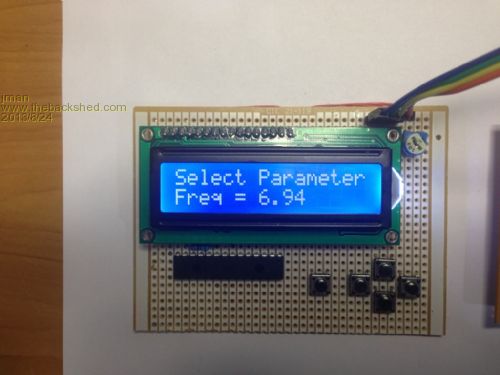

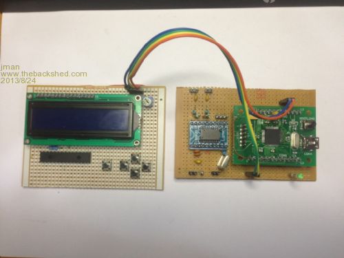

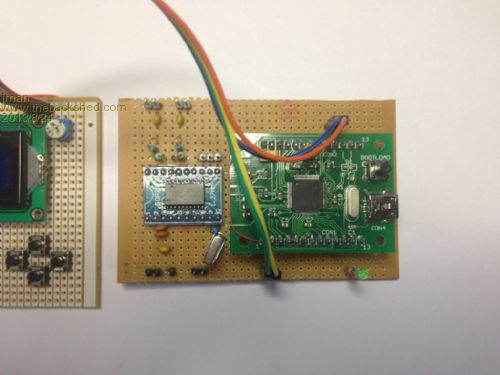

Hi
For those like to play with the electronics in their cars.
I have been working on a programable Knock Detector using a TPIC8101 from TI
This chip been programable via SPI allows us to fine tune the dectection to avoid false detection
The folowing parameters are covered
Frequency (kHz)
This is the frequency that the Knock filter module will listen for knocks at.
The knock frequency can be approximated using a simple formula:
900/(Pi * r) where r = the radius of the bore
With a bore of 76mm the knock frequency will be 7540Hz
Gain
Gain is the amount of amplification that is applied to the knock sensor signal
before it is processed. Aim to keep the Gain setting as low as you can. A setting of around 0.3 to 0.5
is a good starting point
Integration time
Integration time is the length of the sample that is processed. The times are
in microseconds (1/1000th of a millisecond).
Longer integration times will reduce the chance of false knock detection
Knock Sensor
This setting selects which knock sensor to use. Options are 1, 2
ADC Threshold %
This setting determines how ‘loud’ the processed knock signal needs to be
before it should be considered a knock event.
The setting should be around 65% to 75%
Knock Sustain (ms)
This setting can be used to ‘stretch out’ knock events.
You may want to be extended beyond the length of the actual knock.
To use simply hook it up and set the required paramaters
To bring up the menu press the right button and the select button to
step through the options.
The settings are saved to file on the internal drive
Once the correct settings have been applied and tested the I2C LCD module
can be removed refer to this post for the I2C LCD details
I2C LCD
2013-08-24_060119_Knock.zip
The Datasheet for the TPIC8101 can be found here
TPIC8101
My sample MM code is attached
The code is by no means neat and tidy but it works fine
Jman

Posted: 08:13am 15 Oct 2018
hi jman
would you believe this is the exact circuit im trying to build ?, thanks so much for posting it
i have an aftermarket ECU with a knock input but it needs a conditioner , perfect
the other problem i have is i left learning coding about 30 years to late ....
i would be most great full for any advice
so far i have built and tested the mini maximite and a board with the mcp23017 and lcd together with the tpic8101 based on your photos
i am using MM edit to load and run the code to the mini maximite
when i couldent get anything to run i loaded your I2C LCD code and was greeted
with a HELLO WORLD once i changed the 12c commands in your program to the newer
i2c OPEN i2c CLOSE ect .so that proves the hardware works - other than the buttons
would not respond
i can see from your photos that your code works so its something im doing wrong
i see that you wrote the code in 2013 and that MM firmware has had many revisions
should i use an older version to run with your code ?
this is also my first foray into online forums so i shall tread very carefully
and try not to do anything wrong , there seems to be a lot of very knowledgeable
people here so hopefully someone can point me in the right direction
any advice would be most appreciated
thankyou
