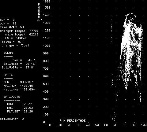

With 1.44 kW of panels at 24v feeding it, 200AH of batteries and a 2.4kW inverter supplying mostly daytime load, The charger hardly gets warm. The main issue with the software is a tendency to overshoot on the battery voltage. On several occasions the inverter shut down with the message "DC bus bad". I have re-written the software into an interrupt driven form and now the overshoot is much lower and no longer bothers the inverter. from watching the monitor, the overshoot is very brief. I will upload a slightly revised circuit and significantly revised software soon.
Here is a screen shot of the activity of the charger over a 1 hour period:

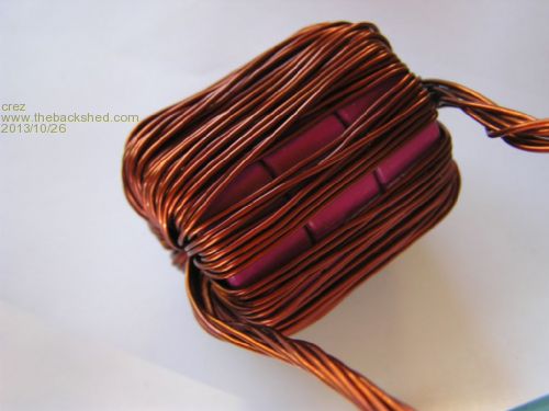

The inductor I1 I made uses three of these:
iron powder core
They are stacked together. The winding consists of 18 turns of 7 strands of 1.2mm enamelled copper wire. The strands are loosely bunched together and then wound onto the three cores, pulling tight on each turn. The inductance at low current reads more like 200uH, but at high current magnetic saturation of the core reduces the actual inductance down towards 100uH.
This may be a bit overdesigned, but the cores degrade if run at too high a temperature. As they degrade, they generate more heat and you end with a thermal runaway situation.
I used a design tool from micrometals which gave me a good idea of what size core and wire to use . The agent for Micrometals cores in melbourne is Magcore.
