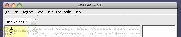

MMEdit 3.4.6 - Installs okay, locks up completely when i open the "Maximite Chat" window immediately after the MMBasic logo from the device is displayed.
MMEdit2 0.9.2 - works okay, is able to "talk" with the device, has some cosmetic issues:
1) Icons missing in editor
2) Default size of "Settings" window too small, Save button is off-screen.

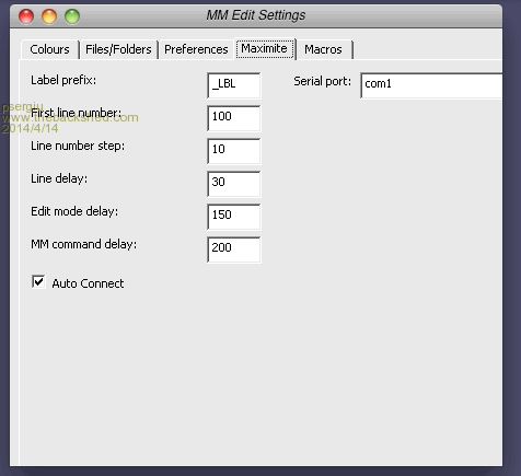

I installed TerraTerm, it can "talk" to the Duinomite-Mega but there's a strange ~1sec delay from my typing until i get a feedback on the screen.
Tried at 9600 and 57600, same delay
I'm using the Windows version. There's no Linux emulation for OS X as far as i know.
I can resize the settings window in MMEdit2 by the lower-right corner - there's no GUI decoration for that corner and the mouse cursor does not change - i guess that's Wine's fault.
The toolbar is there, when i mouse over the button locations i see a little "raise" animation for a 3-4 pixel high area. I clicked one in the left side and i got the "Save" window.
MMEdit2 zip file is unpacked in c:\Program Files\MMedit2, the Data dir is in there.
