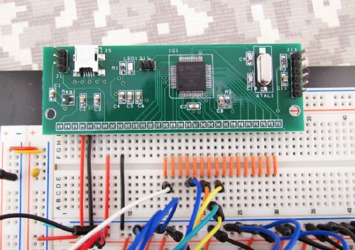

To date I haven't seen a BB(breadboard breakout) available so if one was made how would other MM users feel about it?
Just Think bring out 24 pins as 4 grounds isn't really needed and have the flexibility to design circuits on a BB instead of a sea of holes on some boards.
I have come up with a simple design and would like feedback so feel free to comment.
Regards Bryan

Like this? (CGMMSTICK fits on the board)
Or this? ("Tester" can be used as adapter.)
Edited by CircuitGizmos 2013-07-13

Hi Bryan,
Of course as Rob showed above, Don's Test-A-Mite can do that by using the 30 pin header with straight pins down will be able to plug into a breadboard and a cable to the (MALE) 26pin header of your `Mite (The unpopulated one in CG's Pic above). It is part of the versatility of the board that has not been much utilised/promoted.
Or you could also use Don's DonDuino Cross as a mini prototype board with a 12x12 `sea of holes' It also has an `Arduino' -Sorry Vasi- type header for access via short link wires to all pins on the 26pin headers (not suitable for breadboard though)..

Hi Mick,
As soon as I read your post I reached across and grabbed the 'test-a-mite' Don sent me and it's been sitting there under my nose for all this time. So for me why bother re-inventing the wheel when under my nose IS the thing I need.
