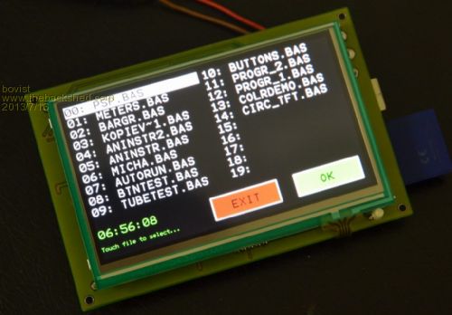

after I got a cheapo 4.3" TFT working perfectly on my DIY Color Maximite (see my other post), I wondered if MMBASIC could also handle a touchscreen. Well, it does -- just needs some additions in MM_Custom.c sources:
YouTube Video
Button and screen handling is completely done by my MMBASIC extension, written in PIC32 ANSI-C. My MMBASIC has commands like TouchButtonCreate(x,y),index,caption$,color etc.
For this demo, I needed only 40 lines of BASIC code. HEX file coming soon! Preliminary schematics can be found on my github repository.

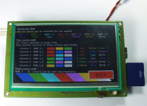

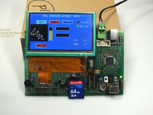

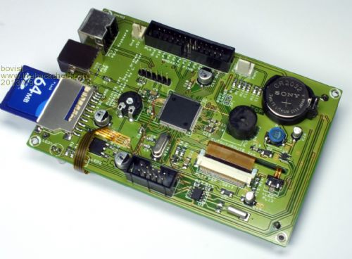

Just got the prototype PCBs for the TFT Maximite last friday and made it work. This is a 2-layer PCB. Shortly beeing proud of the instantly working prototype, but damn, I forgot the resistive touchscreen connector and had to wire it manually. And the touchscreen would need a buzzer for a touch feedback to the user. OK, next try...
Here is a better video of my new TFT Maximite prototype.
Anyway, the touchscreen is a totally new experience to MMBASIC use. You won't need a keyboard or separate buttons anymore. Rework of MMBASIC programs for touch use is pretty easy. On start of your program, you define the active touch items, for example:
TouchItemSize 120,40 'set new bigger button size for all subsequent items
TouchItemCreate(350,220),"EXIT",0,red,B 'create and draw button
creates and draws a Button (type=B) on XY coordinates 350,220, labels it "EXIT", assigns Refnum 0 for first item and colours it red. The line
TouchItemCreate(250,40),"dummy",3,purple,S
would have created and draw a purple ON/OFF switch (type=S) with RefNum 3, caption is ignored on slider switches.
TouchItem(3) = 1
will set switch 3 state manually to "on" (or whatever you like, but all "digital" controls accept only 0 or a non-zero value).
In your programm loop, insert the line
TouchCheck
which handles all touch events, makes buttons look "pressed" or toggles switches, checkboxes and radio buttons.
To query a touch item, use TouchItem(<RefNum>) as a function:
if TouchItem(0) then 'automatically resets button state
DrawLED(352,50),0,red
endif
For buttons, they are automatically "released" if you query them. There might be up to 32 touch items in total which should be sufficient. If you don't need a particular touch item further, it may be removed by
TouchItemRemove(<RefNum>)
or count up <RefNum> in a loop to remove all (even non-exiting ones, the data structure is pretty fool-proof. Here's the BASIC code for the blue BTNDEMO you see in the video:
cls 1 : font #2 : color white,blue
option usb off
print @(100,6) "CMs CUSTOM WIDGET DEMO"
print @(387,52) "MyLED"
print @(387,82) "Blink"
DrawLED(352,50),0,red 'draw a small LED
DrawLED(352,80),0,green
settick 500, ledblink
TouchItemSize 80,25 'set default button size (power on)
' TouchItemCreate(x,y), "Caption", <refrum>, <colour>, <type> (B)utton or (S)witch or (R)adio
TouchItemCreate(50,40),"OFF",0,yellow,B 'create and draw some buttons
TouchItemCreate(150,40),"MyLED",1,red,B
TouchItemCreate(250,40),"ignore",3,purple,S 'create and draw a ON/OFF switch, caption ignored
TouchItem(3) = 1 ' set switch state manually to "on" by RefNum (3)
TouchItemCreate(350,220),"EXIT",2,green,B
'create some radio buttons
TouchItemCreate(350,120),"TEST",4,green,R 'create and draw some radio buttons
TouchItemCreate(350,150),"Opt 2",5,white,R
TouchItemCreate(350,180),"Opt 3",6,white,R
TouchItem(4) = 1
TouchItemSize 80,20
TouchItemCreate(50,230),"CheckMe",7,cyan,C 'create and draw a checkbox
TouchItemCreate(200,230),"or me",8,white,C 'create and draw a checkbox
toggle_onoff = 0
Line(5,80)-(140,210), black, BF
do
x = TouchX ' needed for sketch drawing only
if x >= 5 and x < 140 then
y = TouchY
if y >= 80 and y < 210 then
Circle ( x, y ) ,2, white, F
font #2
print @(200,90) x " " @(250,90)" tX"
print @(200,120) y " " @(250,120)" tY"
TouchRelease ' wait for finger releasing touch screen
' DrawHBar(x,y), val, colour, [BFS], val ranges from 0 to 100
DrawVBar(160,90),y/2.7,yellow,BFS
DrawHBar(210,160),x/4.8,green,BFS ' bargraph with box, fill, scale
endif
endif
TouchCheck ' handle all buttons/switch events
endif
if TouchItem(1) then
DrawLED(352,50),1,red
endif
if TouchItem(2) then 'exit button
for i= 0 to 31
TouchItemRemove(i)
next i
cls black
font #2
colour yellow, black
print: print "Good Bye"
pause 500
run "AUTORUN.BAS"
end
endif
loop
ledblink:
if TouchItem(3) then
blink_on = not blink_on
DrawLED(352,80),blink_on,green
endif
ireturn
Edited by bovist 2013-07-10

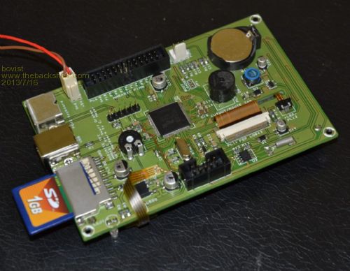

Just a quick question about your prototype. You have the Arduino Connector missing from the schematic but the pins from the PIC32 are assigned.
Also the PCB, you have some pins roughted for the Arduino Connector and others not, as well as no Arduino Connector.
Is this on purpose?
Just wondering as it would be good to also have the Arduino Connector option to play with.

Hi,
I ommitted the Arduino connector since 4 analog inputs plus one digital output are to be used for the touchscreen interface and the buzzer. Also, my new small PCB (only slightly larger than the display itself) simply has no space left...

  TinkersALot said   what tools do you use to layout your board?
I used Easy-PC from Number One Systems which I found very convenient and straightforward to use and reasonably priced. There is a similar free software named DesignSpark promoted by RS Components which is a descendant of Easy-PC (but unfortunately not compatible with Easy-PC files).
