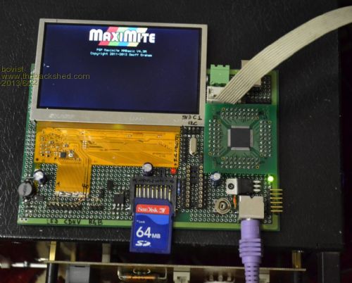

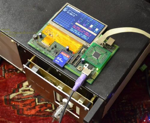

Hello all,
I just got the MMBASIC sources from Geoff (thx for this great project!). Due to his great documentation I was able to tweak it a little, making it work with a cheap Sharp LQ043 TFT (Playstation Portable spare part, available on ebay for around 19 US-$), without any additional hardware (no TFT driver chips etc., just a LED illumination step-up converter LT1932 needed)
Conversion was pretty easy since the SPI outputs the desired clock signal. Connection:
SPI Clock (any SPI channel) to Display Clk
HSYNC to Display HSYNC
VSYNC to Display VSYNC
RED to Display R0..R7, wired together
GREEN to Display G0..G7
BLUE to Display B0..B7
POWER LED port pin by PNP transistor (BC557 as inverter) to Display DISP_ON
Display LEDs need about 20mA @ 22V. Display logic is specified @2.5V, but also works with 3.3V (few mA). Analog Voltage is 5V from LDO regulator input.
I just had to discard the SPI/DMA 4 byte padding to get the display properly aligned. Also a RC delay (5k variable resistor with 47p to Gnd) has to be inserted between HSYNC out and the 3 framing SS inputs. The display is crsip with a resolution of 480 x 272 pixels which yields 22 lines of text. Since the resolution matches the Maximite's, there are no distorted characters.
On the picture attached you see my homegrown Color Maximite (i.e. just the PIC32, PS/2 connector, I2C to my hardware and USB, no other ports yet). Second picture shows a tube testing BASIC prog attached to my tube tester hardware.
If anyone is interested, I can post the mods to video.c (with permission on Geoff) and my schematics. This should also work with other TFTs, although horizontal resolution of 480 is best. The only drawback: You can't use Mode 4 acceptably since it has a different timing (screen is just smaller, rest is blank).
Greetings,
Carsten Meyer
www.keyboardpartner.de

bovist
Joined: 21/06/2013
Posts: 11
Posted: 02:34am 22 Jun 2013
  TZAdvantage said   That is excellent!
I am struggling with getting a display to work that has a resolution of 240x320.
Could you give some pointers how i would possible get that to work.
The other problem is that i have to rotate the screen 90 degrees that is above my understanding of how MMBasic does its video manipulation.
Too busy with too many things. I have it on the shelf for a while. :)
G'day,
just briefly:
1. You need a datasheet of the display. For some strange reason, display documentation is lousy, even from large manufacturers like Sharp.
2. Don't take the timing diagrams literally. If the clock edge fits, you're almost done. The Sharp display mentioned even works with 50 Hz clock instead of 9 MHz.
Does you 320px display has 240 or 320 px long horizontal lines?
Greetings,
Carsten Meyer
