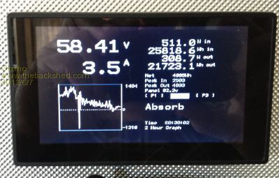

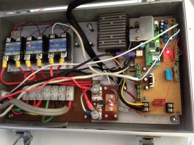

I'm using a Maximite clone to control my solar array for my off grid power system. The maximite monitors battery voltage and current, and switches 3 solid state relays. The solar panels are grouped so that by switching the relays in a certain way I can step up the power in 6 steps, sort of like a binary counter. This is used to regulate the voltage for the charging cycles, eg boost at 60 volts for a couple of minutes, absorb at 57 volts for 3 hours, float, etc.
The other day while I was welding, the output current readings on the display went over 100 amps and caused a error, due to MMBasic trying to format a number longer than it expected. This caused the program to exit, at a time when all 3 relays were switched on, meaning the batteries were fed full power from the solar panels. Lucky I noticed it within a few minutes, and restarted the program. Later I fixed the bug in my code to stop it happening again.

I would go for a hardware / firmware solution external to the Maximite. A watchdog timer is one that has a bit of discussion lately. Another thought is a timer to lockout the higher power states if they are on too long. Given this is mission critical I wouldn't rely entirely on the MM as it can get into a state where if it crashes, it will not restart. Geoff G said that yesterday. When I checked it was at 2:22am today here. Edited by BobD 2013-06-08

I believe that an external watchdog circuit is the best approach. It only requires a couple of 555s and will always work.
I have not tried to implement a software solution as it is impossible to predict and handle all the failures that could stop your program. Your experience is something I had not thought of but other failures could include a CPU freeze due to a power glitch or a hang up due to a corrupt I2C transaction.
With a simple external circuit you can always be sure that, in the absence of a regular signal, the PIC32 is reset and starts up in a clean state... regardless of the failure mode.
While the Error State command would fix one possible issue there are too many other failure modes to make it generally useful. But I will re look at a WATCHDOG command using the PIC32's watchdog hardware as it would be a partial solution for people who do not want to bother with an external circuit.
