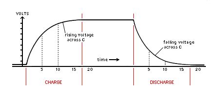

I havent `scoped' the signal.. but it would put a parabolic curved slope on the leading and falling edges Similar to this cct
A gate would sharpen the pulse of course BUT as the SPI input triggers are tied tied together and they are in the same chunk of silicon you can assume that they will all trigger at exactly the same level..
The proof is that the signals still appear to be pixel perfect in alignment on my screen in 80 column and mode 4 (40col??) modes. Maybe other will have a different experience than me.. Time will tell I suppose
