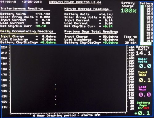

Yes, very nice going Doug. Why the 22v scale on the running display and also what do you estimate the overall accuracy is (i.e state of charge), say over 24 hours? Also, how do you "zero" the state of charge to stop cumulative errors?

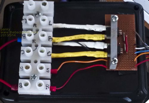

Cliff - picture of the current sensors attached. These are Hall Effect devices with one in the charging side earth lead (solar, 240VAC) and one in the load earth line with the junction of the two being the battery earth. I will knock up a schematic tonight for you.
Input current sensor on the bottom, load current sensor on the top. If you use these devices, be very, VERY carful of the secondary leads - they are VERY fragile hence the clamp on the top. The care is worth the effort as they are extremely simple to use and very accurate.
Two other wires on the bottom are battery 12V and solar panel (up to 22V), both of which are scaled down inside to 0 to 2.5V full scale and fed to analogue inputs on the CG CMM2.

Greg - the 22V scale on the running graph is for both battery voltage and solar panel voltage (actual panel output). Accuracy of the input and load currents should be better than + or - 0.5Amps over a 24 hour period. The days running amp hour numbers are directly calculated from the amps above. As to charge, this is an area where I had to use some guesswork and rule of thumb calculations. I keep two days worth cumulative amp hour input and output and my main concern as a 'vanner is "do I put in more each day than I take out?" In fact due to losses etc. the general ROT is put back at least 10% more than you use.
Also, an unloaded, charged battery should measure around 12.75 to 12.8V and stay stable at this level for at least 24 hours. So every few months, I fully charge the battery, measure and determine the general state of the battery.
From there, I use the rule above - put back more than you take out plus a bit more. As a general result then I can rely on the actual battery voltage under light load to indicate the average state of charge. I choose to try to cut battery usage totally at around 12V which equates to about 30% remaining charge to save the battery. Purists may feel this is a bit low and I use it as my worst case.

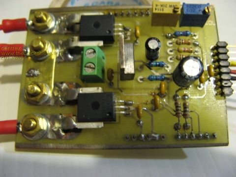

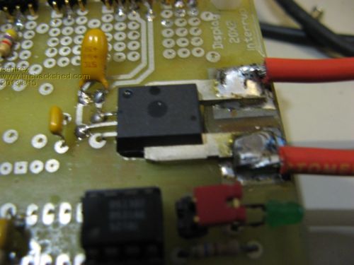

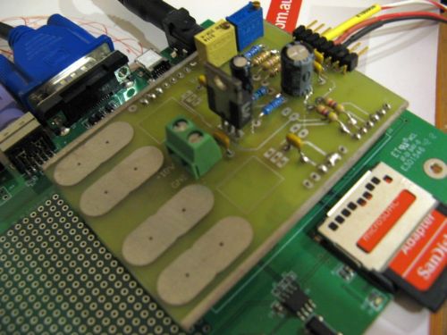

Thanks for the info, I have used the same current sensor but I recessed mine into a pcb so all pins were soldered down no problem with fragile pins.
Using this sensor certainly reduced the complexity of your origonal system.

PCB mount is definately the way to go as you have done. PCB designing is still on my to do list - I have been playing with Design Spark a bit to get familiar.

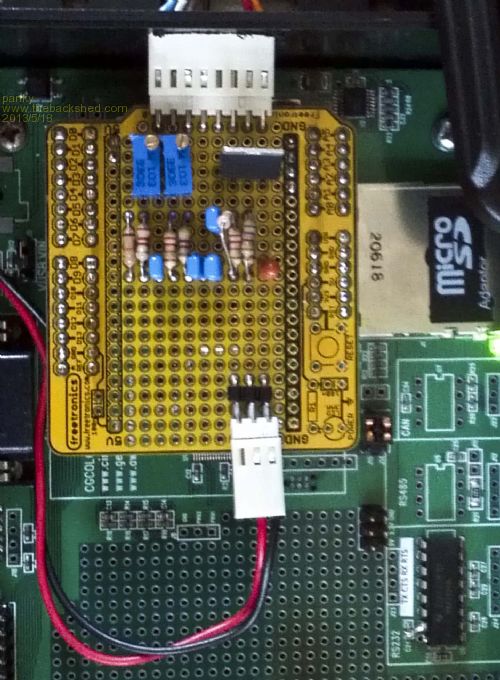

For Tassie Jim - the interface from the ACS758 to the MM couldn't be simpler - just feed earth and 5v back to the ACS758 and take the Viout pin into an analogue pin on the MM.
The only slightly fiddly bit for the unidirectionals is to calculate the offset. I wrote a simple little loop that sampled the pin and averaged the value then stepped the offset down from .8v down in 1mV until zero. This then became the offset I used in the main program. Mine worked out to 582mV.

Doug, how do you manage to read all that on a 7" screen? I've been running your new simulation for a couple of hours now on a 23" screen and it's pretty "busy" even on that. Would it be a major drama to be able to incorporate a press-button or knob to quickly be able to switch between say, three or four different screens that showed various blocks of the full display and have it running normally on the most important one? That way you could read it on the wall while sipping your morning coffee!

Tried the simulation on a 19in screen looks very good but as the Graynomad commented it would be rather busy on a 7 in screen what you get used to I suppose and what info you are looking for.

Yes, the display is pretty busy - I am working on a version to do exactly as you suggest - multiple screens, probably all at font #2, selectable from inside the van.
