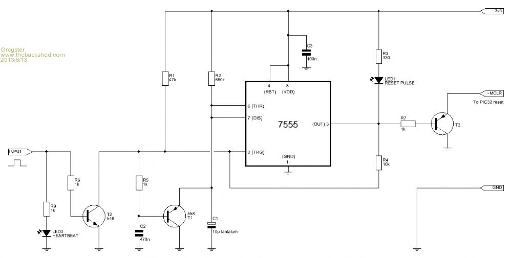

Hi folks.

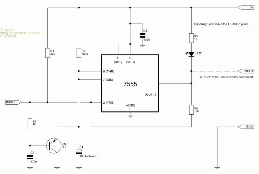

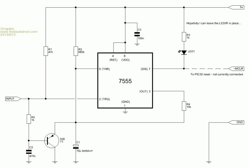

I just need to revive this thread for a few more posts, as I am now playing around with the watchdog reset idea for the MM.

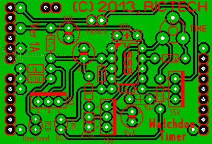

I built the 555 missing pulse detector linked to by centrex, and although it works very well indeed, I have found one really major issue with it, so I want to run it past the rest of you for ideas.
The problem with this circuit, is that on initial power-up, the 555 output is low, meaning that if connected to the MM, at power up, the 555 circuit will hold the MM reset line low, the PIC32 will never start-up, and the MMBASIC code will not run to be able to start sending pulses to the 555 circuit in the first place.
See what I mean?
Once I start manually pulsing the input to the 555 circuit, the 555 output goes high as expected, and provided I keep pulsing the input, it stays high. With my experimental R/C combination of 560K/10uF, once I stop pulsing the input, about 6 seconds later, the 555 output goes low. Start pulsing the input again, and the 555 output goes high again and stays that way while I keep pulsing the input.
That is all GREAT, and EXACTLY how I wanted it, but the initial power-up problem with this circuit still remains, in that if actually connected to the PIC32, the 555 will pull the PIC32's reset line low, and keep it there until the 555 input starts pulsing. However, as the PIC32 is held in reset like this, it never starts up, the code never runs, so the pulses never start, and the MM stays in a state of electronic limbo forever!
Does anyone have any ideas on how to stop that?
I KNOW I can do this with a PICAXE 08 chip no worries, as you can program the PICAXE to wait for a few seconds at power up BEFORE it starts looking for input pulses.
...but I liked the idea of NOT using an MCU-based watchdog, to eliminate issues with the watchdog leading to the "Blind leading the blind" as mentioned earlier in this thread by MOBI...
Come to think of it, this 555 circuit has the exact same problem when it DOES reset a running PIC32, as it holds the PIC32 reset line low when tripped, instead of a pulse on the PIC32 reset line, which is what we really need...
I think I will have a play around with the PICAXE method, but I would still love to hear other members' input - it could be a simple enough fix. Edited by Grogster 2013-06-10

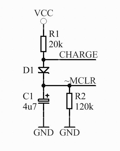

This is just an idea for you.
You can actually build a missing pulse detector in a much easier way. All microcontrollers have Schmitt triggers on their reset input (at least PICs certainly have) and you can use it by adding a simple RC circuit outside. Additionally you don't need to generate the external reset pulse on power up event as it is internally generated by the PIC.
See the picture.
You drive the 'CHARGE' from an output of the PIC, periodically charging the capacitor, which then slowly discharges itself through a resistor and feeds the '~MCLR' input of the PIC. When the voltage gets under the reset threshold as per the datasheet, the PIC will reset itself. So you have to periodically recharge the capacitor by sending a short pulse to it, to keep the micro from resetting. The values of the resistor and the capacitor can define the maximum reset period.
Edited by kiiid 2013-06-10

Posts: 10114
Posted: 07:38pm 08 Jun 2013
An excellent idea and so simple!
I will try this out, but I think we would still have the same issue, would we not, in that at power-up, the reset(~MCLR) line will be held low by R1 in your diagram, so the PIC never actually starts running.
Yes?
No?
I will set this up on the breadboard and try it out with LED's.
Thanks for posting and for the diagram - I will let you know what happens.

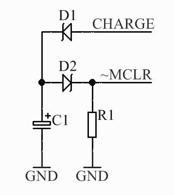

Posted: 08:03pm 08 Jun 2013
That could be a problem unless R1 is a value high enough (I think there was an internal pull-up on the MCLR input).
But that potential issue could be easily solved by adding a pull-up resistor on the 'CHARGE' line (before the diode!). Thus it will provide the initial charging for the capacitor and later on it won't matter because you will be holding the line low by the output unless charging.
This one should be fine in all cases. In fact you may not need D2 at all. I put it there only to neutralise the effect of the internal pull-up, but it is very small anyway.
With these values it should give you a nice window of about 0.5s to recharge.

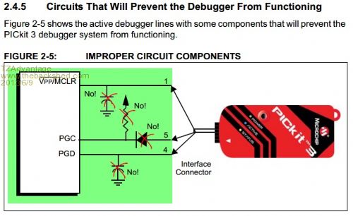

Posted: 10:49pm 08 Jun 2013
You still need to follow these pic programming rules when you want to be able to program the pic.
Make sure you can take that capacitor and maybe other parts that interfere out of the circuit by jumpers or switches when it is time to program.
And in case you missed its discussion see here: forum post , Geoff is thinking about adding a WATCHDOG command to MMBasic that uses the internal pic32 watchdog removing the need for extra circuitry.Edited by TZAdvantage 2013-06-10

If the capacitor is temporarily disconnected (let say through a jumper), there is absolutely no issues with the programming.
