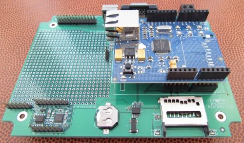

There are network shields available for the CGCOLORMAX2. I have not done anything with the one I have.
