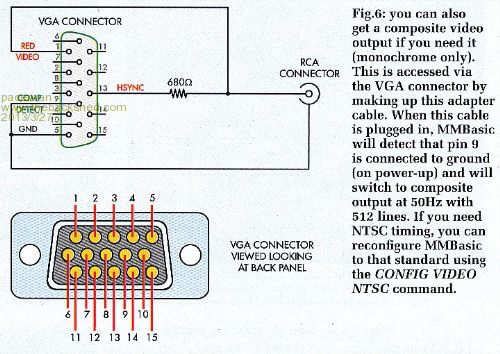

Also from Geoff's CMM article in Silicon Chip magazine Oct 2012:
As noted in the image, you'll need to make up a VGA to Composite (i.e. video) adapter cable to plug into the UBW32-CMM VGA port and then the composite video end to your composite screen.

Thanks Paceman, but I thought that composite connection can only be monochrome, and the 5" screen talked about are probably colour. Is that correct ?
I did read the pages you refer to and have no trouble making up an adaptor, but lack of colour bothered me somewhat.

Yes, the composite output can only be monochrome and it goes to a composite video input, i.e. TV-type screen. It doesn't matter that the video screen can display colour (like a TV) because all you'll see from the UBW32 CMM is mono, as it is for all the colour Maximites.
The 5" screen mentioned by Bill.b above is a colour composite input screen usually used to connect to reversing video cameras on cars or security systems. Composite video inputs have just the one central active input pin, usually a yellow RCA connector and that one pin can supply colour if the signal to it has the colour information - that's not the case with the CMM's composite output.
