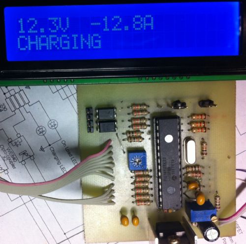

I have built Gizmo's PICAXE Charge Controller.
However, I desperately need some help since the PICAXE-28X is obsolete. I do have one PICAXE-28X1 and one PICAXE-28X2.

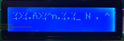

Whenever I programmed PICAXE-28X1 with version_1.2 code the LCD would display okay,
but when I used the 2010c version code it does not work.
The LCD I am using is LCD Display 20 x 2 Blue Character with Backlight
from taydaelectronics.com
I then try the built-in conversion tool from the program editor on the PICAXE-28X2 and the same result. first code works but the second one fails.
Any help is highly appreciated....

Can anyone please help me find a PICAXE-28X?
I have been trying to get this thing to word with the PICAXE-28Xx1 chip but only the first version works. I guess I need a PICAXE-28X chip for the version 2 to work.
Please help me!
Posted: 09:37pm 20 Mar 2013
You might try to invert the serial signals or using a different divider.
You can do that by using a baudrate constant that starts with a T or if you already used that switch it to one that starts with a N.
Also be aware that when using a faster clockrate you also need another baudrate constant.
they end with _4, _8 or _16.
I think a newer chip will run faster, with a higher clockrate.
As an example if you used T1200_4 before it might work when you change it to T1200_8 or T1200_16.
If you have a scope or logic analyzer you could look at the signal and compare it to the signals from the other chip. As they are serial they should look the same.
