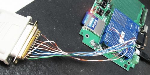

I was cleaning out my work area and up on one of the shelves was a Panasonic printer. So just for fun, I made a printer interface for the CGCOLORMAX2. Wiring only took a few minutes, as did writing the code.
Here is the hardware:

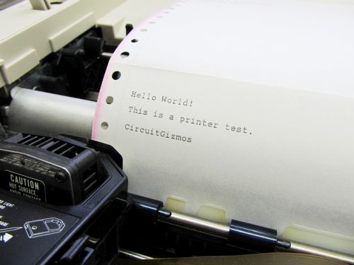

Here is the text file:
Hello World!
This is a printer test.
CircuitGizmos
Here is the result:
Ah, to hear dot-matrix again!

Can you please post the circuit?
I see you have a yellow thing soldered to the LPT plug - I am guessing this is a resistor network in the area of 10k or so as pull-ups on the data lines?

  Grogster said   Can you please post the circuit?
Yes. That is a 10k resistor pack. Pulls pins 1-9 on the 25-pin connector up to 5V. Pin 1 is the printer data valid line - when pulsed low the printer accepts the ASCII data value on pins 2-9.

I used 5V logic to be sure that it would work with this printer. Centronics +5V isn't supposed to be used for anything, according to the printer manual.
This is just an example "how-to" I did mainly because I had the printer. I'm not defining any particular pins as Maximite printer interface pins. The printer interface has more than just the 8 data and one signal line - I made this as minimum as possible. There is, for instance, a 'ready' line that would be used to let the Maximite know that the printer is ready for more data.
