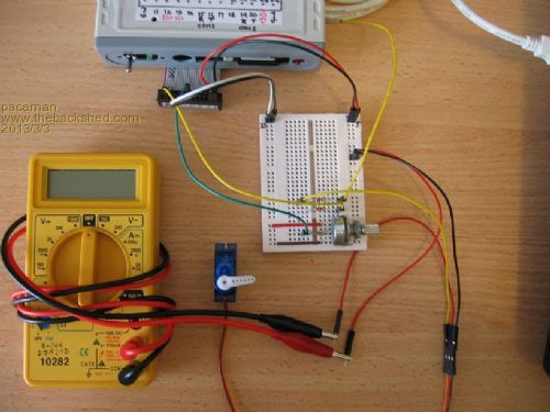

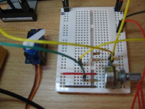

Mini servos are usually used for control of models (planes, boats etc). I've been looking at one of these "Tower Pro SG90" (cost $4 from Deal Extreme, free postage) for a different job though i.e. to replace a small solenoid to release/lock a cat door! Solenoids are a lot more expensive, draw a fair bit of current (the whole time they're 'ON') and in the case of small solenoids they're not very powerful. The servos are geared DC motors and very small ones can produce a lot of torque. In the case of the SG90 (which is tiny) it can produce 2kg of torque and will hold it's position with very little current e.g. < 10mA.
I've used this test setup to try different methods of controlling the servo using MMBasic V4.3 and the Maximite.
The test rig has the 3.3v MM supply connected across a 10K pot and the wiper voltage (green wire) is read on one of the analogue inputs (pin 5) via a 100 ohm resistor. That's scaled using MMBasic to give the correct pulse width for that position of the pot/servo. The servo connector has three leads, gnd, 5v, and it's pulse control lead connected to either a digital out pin or the PWM output, in both cases (yellow leads)via a 220 ohm resistor (more on that in the info below).
The servo control is achieved by varying the pulse width between about 1-2 milliseconds and the pulses need to be maintained at about 50Hz (but the 50 is not critical). I've used the PULSE output command and the PWM command to do the control.
Surprisingly (I thought) the PULSE control was much better and the PWM control was very jerky.
The code is below (it's pretty simple )and allows testing by either manual width input or input from the potentiometer (much better). I've included a lot of description for those unfamiliar with the servos.
Any comments gratefully received - and thanks again to TassyJim for his MM Edit program which makes life very easy!
Greg

'Testing is conveniently done using a 10K linear pot connected across the
'Maximite's 3.3v supply and connecting the pot wiper to one of the Maximite
'analogue input pins via a 220 ohm resistor. Voltage at that pin can then be
'read by the program and scaled to provide the control pulses. The amplitude
'of the control pulses is not critical but should not exceed the 5v servo
'supply voltage. 3.3v pulses work well.

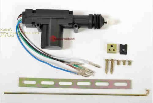

Congratulations on operating the servo. I think that you are first to publish on using the Maximite with servos?
Reading about your application I remembered a lock method that I have used.
A car electric door lock actuator is an answer. These will give more than 25 mm of pin movement, only draws power when opening or closing and retain position when not powered. Their geared down motor method gives a long stroke with reasonable force, enough for a locking pin.
To reverse the direction of travel the motor supply (12 Volts) is reversed. Usually only 1 of the 4 units in a car is a master unit with limit switches to turn off the supply at end of travel. I have included a borrowed photo and a link that leads to a description of another actuator sold by Jaycar (from whom I think that you must buy a kit of 4). A drawback could be the requirement for 12 Volts at maybe an amp of current, I cannot remember but as the little motor is geared down it may require less.
A good source would be a car wrecker.
Keith W.

This section of comments in the program needs editing (it's correct in the description given in the post).
The wiper is connected to the analogue input pin via a 100 ohm resistor - not 200 as shown above from the program listing.
Also, the paragraph quoted above should have the following sentence at the end.
"The servo pulses from either the PWM output or the digital PULSE output pins are connected to the (yellow) servo control lead via 220 ohm resistors."
Greg

  Keith W. said   Hi paceman,
Hi Keith,
Thanks for that - I surprised myself! I knew nothing about them until a few days ago. Most of the information, except program which is all mine came from the Polulu site, Servo Primer
About the car electric door actuator - they're a good option but too big for my project and as you said, they need 12v, the same as the little solenoids do. The servo running off 5v is handy.
I remember seeing one of those being used on U-Tube operating a 90o water hose valve. The bloke that did it had trouble with tom-cats smelling up his yard so he rigged up an IR beam at cat level that triggered the servo when the cat walked through the beam - immediate high pressure hosing To make it more interesting he also pre-triggered a video camera (another beam?) for a few seconds and posted the action. He also got to find out who the culprits were. The video's probably still there somewhere.
(BTW, I actually like cats generally).
Greg

Input controltype
On controltype GoTo Keybd_PULSE,Keybd_PWM,Pot_PULSE,Pot_PWM
Pot_PULSE:
SetPin 11,8 'set pin 11 as digital out
Pin(11)=0 'set pin 11 to 0 (in case it's at 1)
SetPin 5,1 'set pin 5 as analog in
SetTick 20,Pulseout 'interrupt for pulse out every 20mS (50Hz)
volts = Pin(5) 'read wiper voltage at the pot position
width = (0.5454*volts)+0.6 'from: slope=(2.4-0.6)/3.3 and y=Sx+c
'v$=Format$(volts,"V= %4.2f ")
'w$=Format$(width,"W= %4.2f")
'Print v$,w$
key$ = Inkey$
If key$ <> "" GOTO Initialise
loop
Pot_PWM:
SetPin 5,1 'set pin 5 for analog input
do
percent = width*5 'assuming frequency of 50Hz (i.e. 20mS period), thus %=width*100/20
PWM 50,percent 'start 50 Hz continuous pulse train
'w$=Format$(width,"W= %4.2f ")
'p$=Format$(percent,"Percent= %4.2f")
'Print v$,w$,p$
Pause 20 'seems to be needed, otherwise no pulse output
key$ = Inkey$
loop
Pulseout:
Pulse 11,width
IReturn
Wait:
key$ = Inkey$
If key$ = "" GOTO Wait 'wait for a keyboard press to input another pulse width
return
I've removed the voltage divider in the PWM output as per your discussion under "Sound Output" in the March 2011 SC issue. The 1K to ground is now disconnected, the 5.6K is replaced with a link and I can see the full 3.3v pulses on the scope from both the PWM and I/O pin 11 that I'm using for the PWM and PULSE control cases respectively. I've also got just a 220 ohm resistor in series with each output to the servo control wire and I plug/unplug each depending on which control method I'm using. For both the PULSE and PWM control cases I'm using a nominal 50HZ period.
Using PULSE control and the TIMER interrupt the pulses are rock steady on the 'scope and widen smoothly as the pot is rotated.
With PWM control the period of the pulses jumps around a bit (typically between about 18-22 mS period) and jumps around a bit more (typically between about 16-24 mS period) if the extra print statements etc are being used, i.e. not commented out as they are above. The pulse width is still constant for a given pot position but as the pot is gradually turned the pulse width doesn't widen (or narrow) with it smoothly but jumps in about 0.2 mS jumps - this is seen on the 'scope and in the servo positioning. From what I've read Servo Primer the variable period apparently shouldn't matter - and doesn't seem to, because if the pot is not moved the pulse width is constant and so is the servo position, even though the period is jumping around by a few mS.
I don't know why the PAUSE is needed but certainly with the above code, if it isn't there the PWM output pulses don't start. I tried shorter pauses but 20 is needed.
Many thanks for your help.
Greg
