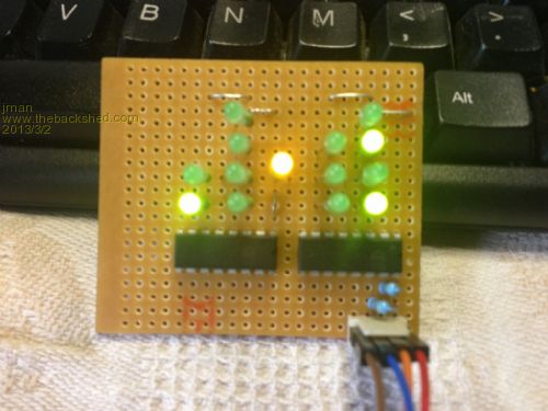

Hi All
I thought I would share my Saturday afternoon creation
Nothing spectacular just a Binary clock using I2C and 2 PCF8574 expanders
Could have just used the Maximite's I/O pins but I like the idea of a little
add on board with just 4 wires.
Left columns are hours (Tens - Units). Right is the minutes (Tens - Units)
Amber LED in middle flash's at 1 second intervals
The time shown is 10:05
Source code attached (rough and ready but it works)

Nice! I like that!
