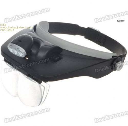

Hi Mick
I find this a great help when checking my boards and soldering.
http://dx.com/p/light-head-magnifying-glasses-with-4-pie ces-different-multiple-lens-3-aaa-51583">
Edited by Bill.b 2013-02-22

@Bill,
Yes, they are great. Downwind and I both use something similar - I don't find the head lamp much use though and prefer a back light and desk lamp.
