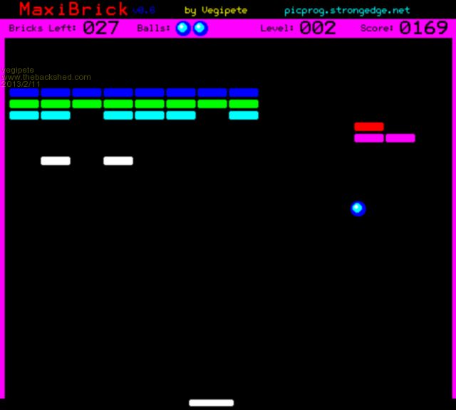

I've been busy writing a little ditty and here are some preliminary results.
Put the various files all in the same directory, then run *.BAS
Enjoy, and criticisms are welcome.
Source code commenting is a bit lackadaisical and I have been evil and used numerous hard coded constants but hey, what of it?
The game uses an analogue input on pin 1 to control the paddle position.
So sound yet...
/vp

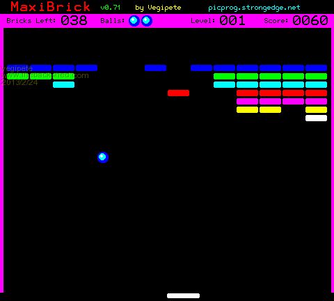

I've worked some more on this game. Now there is sound, demo mode and I added keyboard support per Nick's suggestion. But boy do I find keyboard control difficult! If anyone has suggestions for better keyboard control, I'd love to hear it.

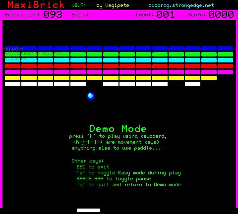

As you can see, the demo screen includes basic instructions.
As before, the paddle is controlled by a pot on pin 1. However, the pin is defined in a statement near the beginning of the program and can be easily changed to something else.
I have also programmed CTRL-SHIFT-F12 to grab the current screen and save it to the SD card. The current time is used for part of the file name so over-writing existing files is a not too likely.
So without further ado, here is version 0.71
Enjoy!
/vp

Very good!
It looks good (good choice of colour) and the ball movement is excellent.
I like the way you have the instructions text at the demo showing off the Sprite capability of MMBasic.
You're right, the keyboard control is it's downfall but the same can be said about many games, my Donut Dilemma included. Keyboard is not a game playing device.
Unfortunately, you have to include it so that everyone can experience the game.
It may entice people to make a joystick interface (Atari interface also has X/Y paddle inputs)
Have you interfaced your paddle to the "standard" pin connections as defined by Darthmite?
The keyboard may be easier if using the left/right arrow keys. Also, is the H key a faster version of the J key?
It's good to see some great software that utilizes the power of MMBASIC coming out.
Good work!

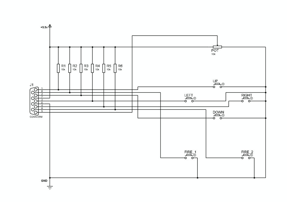

Here is the joystick scematic...
It doesn't list the Maximite pins but I know the buttons I use for Donut Dilemma were:
11 = UP
12 = DOWN
13 = LEFT
14 = RIGHT
15 = FIRE (Button 1)
Has anyone got definitions for Button 2, X-POT and Y-POT?
Darthmite? What's best here?
Nick

Another suggestion for your great Bricks game vegipete...
Create a BMP image that has the Demo page, complete with bricks, borders and zeroed readouts.
Include a nice graphic in the area where you have the text then type over it in a brighter colour the text you want to display (choose a nice font, even add a fancy Title text).
Then simply LOADBMP this page at the start. You can then take out all the linesof code that setup that screen, including the PRINT lines for the text.
NickEdited by Nick 2013-02-25
