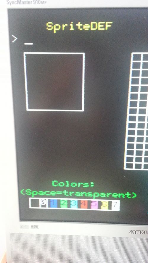

Grogster i think that there are some disturb... i've the same problem, try changing video resolutions some times with MODE 1 and MODE 4.. eventually you get a very disturbed video output, i'm not using a real maximite, i use a UBW32 on UBW32-MCC-PCB
maybe it is only my configuration...
i've a photo of the disturb...
Edited by Juri74 2013-02-10

Yes, I see what you mean - thanks for posting the photo.
Not to dismiss your photographic evidence, but is it not possible that it is just an LCD artifact as mentiond above by Nick?
Some LCD's are better then others at upscaling, so I understand.
In fact, it is not uncommon for some of the modern LCD's to do a piss-poor job of upscaling, if they are not fed with the exact resolution that they are designed for...
Still, and again - not to dismiss your results.

Posted: 02:06am 09 Feb 2013
eheheh maybe, but the problem completely disappear if i put a finger on the left strip of pins of the pic32...
i tried it on a 50" plasma tv(16:9) , a 26" pc monitor (16:10) the monitor in the photo a 19" (4:3) and a 7" 16:9 monitor... same problem everywhere, however ofcourse on the 7" monitor that problem is very hard to view ;)
i've no crt monitors actually :(
Posts: 10104
Posted: 02:13am 09 Feb 2013
Ahhhh - I see - your photo was of a 4:3 screen.
Yes, that is interesting then....
Please keep us all updated if you fix it.
The fact that you putting your finger on the side of the PIC32 fixes it, suggests some random capacitance issue, and that some extra decoupling caps on the RGB video or perhaps the vsync or hsync signals might help - I'll defer to the experts here on that one.

That should not happen. It sounds like you are not using fast diodes to clamp the video output. 1N4148 diodes were specified for this reason. Also check the value of the resistors on the video output, the VGA cable, etc.

i'm using 1N4148 diodes.. the fact is that when i turn on maximite there is no problems at all, then i switch to mode 4 and again no problems on video... the problem appear after some switching from mode 4 to mode 1 (2&3) and back again..
however this is not a big problem for me at this point..
for the resistors i used 120 ohm, all components buyed from RS Components..
Juri
Posts: 3372
Posted: 03:02am 10 Feb 2013
Ah, switching in and out of mode 4 is the clue.
There is a bug (feature?) in the PIC32 which can cause the three SPI channels to start at slightly different times which results in a slight colour fringing (you call it fuzzy). By hand tuning the code I can eliminate it but going into and out of MODE 4 will often make it reappear until the MM is rebooted.
At this time I don't have a fix but it is at the top of my todo list.
