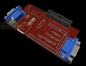

At the moment i have this design in mind:
I don't have all the 3d parts yet so the render is incomplete, especially the VGA connector on the top left and the microsd front center. The idc should be a right angle.
