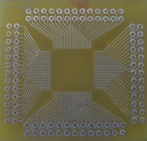

Hi all,
I have two colour MMs and am really having fun with them.
I wondered If I could grow one from the ground up, so to speak.
I have made a lot of PCBs using the Kinsten method (UV)and wondered how hard it would be to etch a 100 pin pic32 footprint. I am staying with Downwind so we decided to give it a go. The trace size is about the same as for "through pin" tracks with which I have had fair success. The 100 pin fotprint is a bit more daunting, but we did up some artwork on plain paper using a mono Brother laser, exposed and etched a board.
The board turned out quite good although the tinning rippled up a bit. No shorts and no breaks. So far so good. Now I wait for my pics to come for the soldering bit.
I know one can purchase boards like this one from futurelec (and I have some on the way @ $1.25ish each), but wanted to try it anyway.
Work in progress. It is only the hardware I'm tackling. I intend to load MMbasic.
