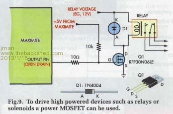

You sure do need a transistor or mosfet
That is from the original Maximite article

You need the diode etc as well.

Hi Heppy
Take a look at this web site
Drive a realy with a PIC

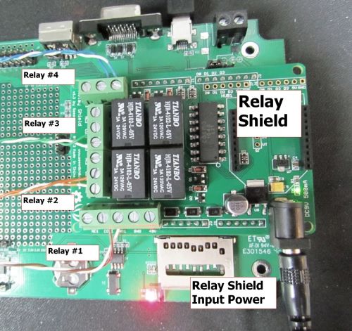

Here for reference is a relay shield on a CGCOLORMAX1.

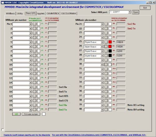

And controlling the relay with MMIDE 3.
