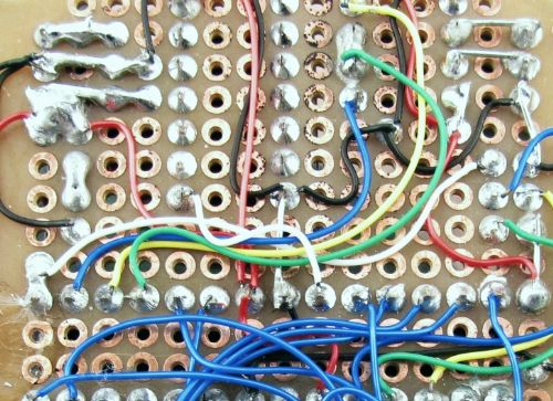

Tempted as I was, I never really got hold of wire wrapping, instead, preferring to use the same kynar and mylar wires to "touch" solder the wires on the underside of the board, keeping the stripped bit to about 1 mm. I built an Apple 2 computer that way, and it worked well. I found that if you used a pointy soldering iron and a pair of tweezers, you could solder one wire on to a IC base or component on one side without de-soldering the wire on the opposite side of the same pin.
I still use that technique much to Downwind's disgust. That is if I haven't done a PCB.

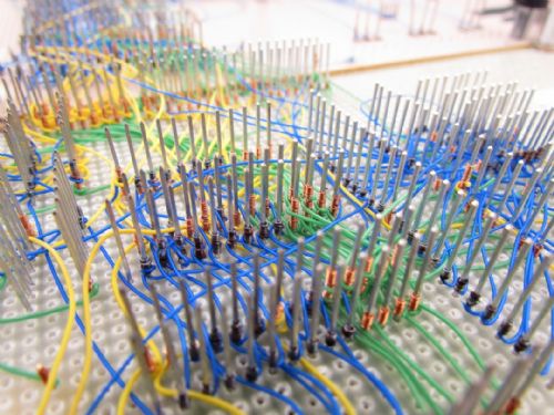

I found something I wrapped more than 30 years ago. Z80-based controller. And it still runs, partially.
The monitor runs and works fine. The application code was stored in battery-backed RAM and even if it still ran, there are a few missing parts.
Picture of wire-wrapping:
I have more colors of wire, now, as I use it to do point-to-point wiring.

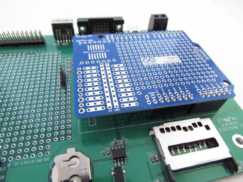

Don't forget that there are "prototype" shields that can be used on the shield footprint area:
