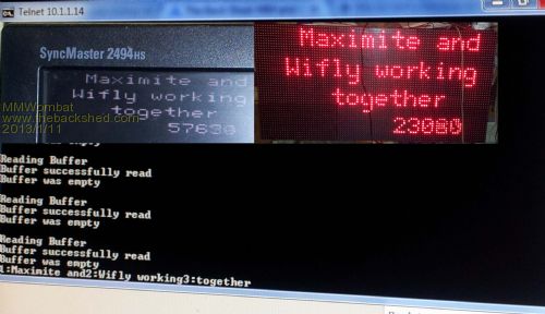

Posted: 11:01pm 10 Jan 2013
All,
I am using the wifly module. I purchased it from little bird electronics..
The wifly RN-XV module cost $40, and its headers are 2.0 mm pitch not 2.54mm(0.1").
Doesn't look like it would fit as an arduino shield. Each header is about an inch apart.
Web stuff here..
Here is a picture of telnet window with two pictures in picture. One of the MM vga output, the other is output on 9 panels (3x3)...final would be 21 panels 3 wide by 7 high
regards Dennis

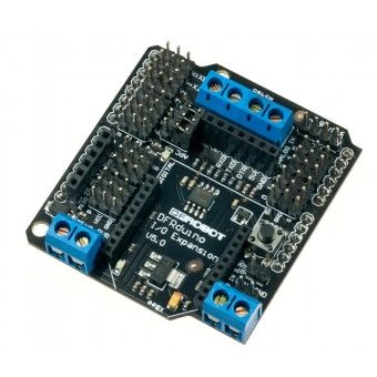

You can plug it into this shield.
The RN-XV is pin compatible with the XBee modules so any shield that supports XBee should support the RN-XV.
These are available everywhere including DFROBOT.com and EBAY.
