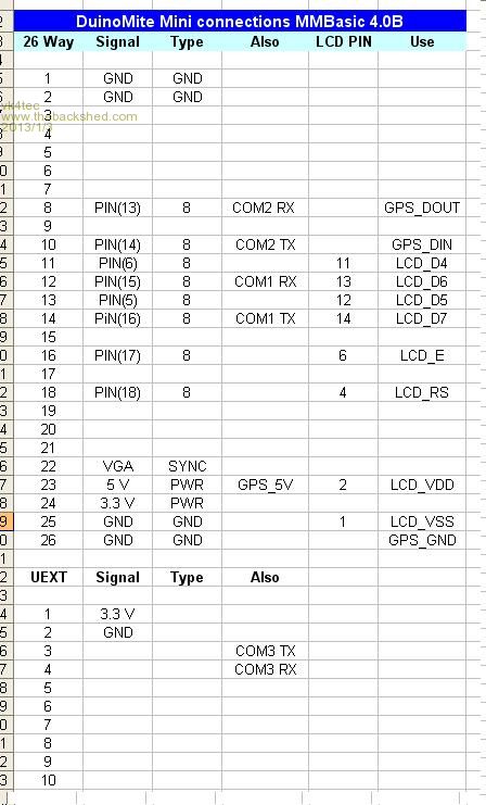

Hello
I am re-visting an LCD/GPS setup.
My DuinoMite logger currently uses COM1 under MMBasic 4.0B
I have a clash, and I need to move to COM2
COM3 is still on the UEXT connector.
Geoff, et all, can you confirm please that COM2 is PIN(19)IN and PIN(20)OUT
Anyone had better results with ribbon cable ?
I have the grey stuff and its pretty fragile. ( wire is pretty thin )

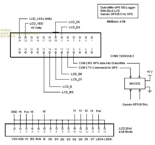

vk4tec
Joined: 24/03/2012
Posts: 239
Posted: 01:04am 03 Jan 2013
Here is a graphic of my connections
- Andrew -
