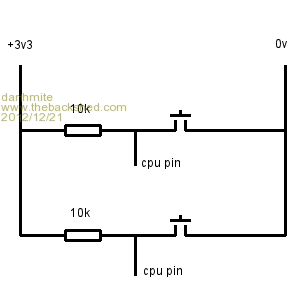

Can any one tell me the joystick pin connection to the maximite I try the pin 13 left and pin 14 right and pin 15 fire to the CON6
I am trying to connect a joystick to the maximite where do I connect the wires to the maximiteEdited by rambo55 2012-12-22

Hi ,
Read the game header to know how to connect the potentiometer and the fire button.
If you use the "pin 13 left and pin 14 right" then it's the 'Old' version.
Try the Invaders for Colour Maximite v4.x
Now if you prefer the old version running on B/W Maximite in pre 4.x version.
You have to put a 10k resistor between the direction pin and the +3v3 and the button
from the cpu pin to 0v
