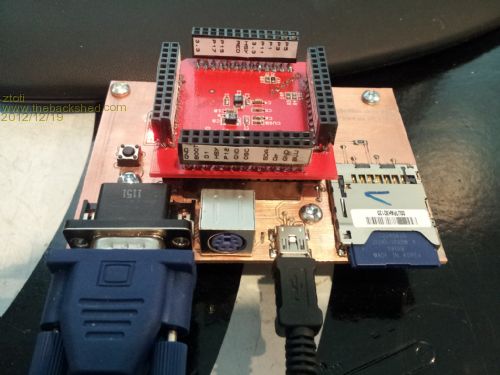

I bought the TQFP 100 adapter, http://www.ebay.com/itm/TQFP-100-TQFP100-0-5mm-pitch-Adapter -PCB-PIC24-PIC32-/140756927892?pt=LH_DefaultDomain_0&hash=it em20c5c44594 and I build the Maximite arround it.
Why?
I use the Maximite like other regular PIC in my projects and after develop the software and the circuits ( jumpers from Maximite to rest of the circuit), I lift up the adapter and implement on the new circuit - so simple to me. :)
Thanks a lot Geoff.
Posts: 3372
Posted: 04:05am 19 Dec 2012
That is great. I think that it is wonderful the variety of form factors and construction techniques that can be used.
I used a TQFP adapter to develop the first Maximite, they are an easy way to handle these types of chips.
