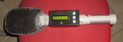

I'm (slowly) working on a 125KHz animal tag reader project using the Mini Maximite as the controller and the reader is a slave module made by Priority One here in Melbourne (Model RFIDRW-E-232 - Atmel Mega 168PA based). Communication uses RS232.
I'd be interested in your cattle reader project as a more embedded option than the RFIDRW-E-232 module. Where can I find information on the project?

I originally did it on the Ozelectronic forum but I'm happy to do it here again stage by stage if you like. I had always intended to Atmel it (currently runs picf88 as master/number cruncher) as well I would like to "blue tooth" it so no download cable is needed - currently dumps into a usb-serial cable.
The prototype is a bit rough - works on 6 to 8 half flat AA cells with a read range of about 180 to 200mm. Good enough for yard work - works in a pen of cattle if you fit unit to a bamboo pole or the like and scan over the animal's heads. Unit will not record duplicate tags, and will hold up to 600+ tags with group separators (blank tag) for multiple herds.
