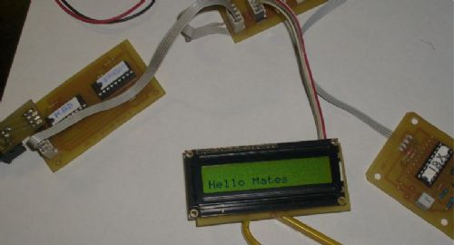

Some time ago I did up a pic16f88 to interface to a pc keyboard to produce 8 bit parallel output codes. (all shift, alt and control functions)
Then I thought it would be handy to make the PC keyboard an I2C device. Problem!! Both the keyboard and I2C are essentially serial. So...I hooked up another pic module originally designed for IR. That means I have two chips back to back with handshaking in between to stop timeing clashes. Worked quite well.

Here is the i2c ps2 keyboard details. Yes, I know ps2 is rapidly dying but some of us have a few of them still and it is easier (I think) to interface to a ps2 keyboard than a USB keyboard.
This module can also read IR remotes (the "standard" type) if the KDB pic RA2 (pin 1) is tied high instead of low. A different arrangement on the kbd input is then required. Not much more than a IR receiver and a resistor.
There should be enough data in the zip file to build one - there's even a picaxe bas file to read the keyboard and display on a 2 line LCD i2c module (That'll be another post).
