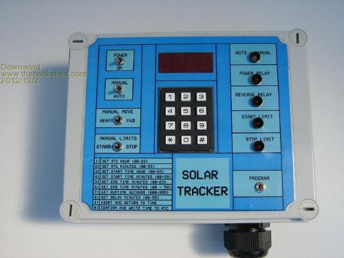

I have used many of Davids developments for projects (often in projects for other forum members here) and they work well.
An example is the keypad used in a solar tracker here.......
This uses Davids I2C keypad chip for the keypad.
His I2C LCD display has also been used in many of my projects too.
If you can program a 18 pin PIC chip with the source code David has written then its easy to create several different I2C slave chips to suit different applications.
Basically one (or 2 chips) types can be programmed as slaves to do different operations.
Yes you can buy a dedicated chip for the same function, but the advantage is having a few blank Pic chips on hand, that you can make into a slave to suit your needs using Davids software.

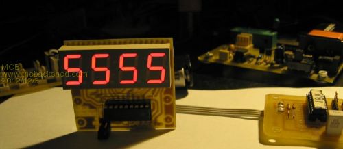

Here is a 4x7seg led i2c module for the pic16F88.
The display is driven by the picaxe 18x. I2C pull up resistors are on the 18x board.
The led can be common anode or cathode (software selectable)
The zip file has the hex code to allow programming. I used a single 4x7seg display block from Aztronics in Adelaide but single led displays can be used.
I'll go into a bit more detail after I have posted another 2 or 3 modules then we will tie some together to get them to interact.
After that I'll go into the source code and show how to "grow" an I2C module using a template that I've developed.
Questions please as I don't just want this to be a tute.

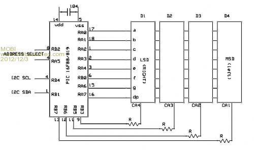

There is a schematic in the zip file (or there should be). I have artwork for PCB in PCB express format which I'll probably put in a zip file with all the other layouts or on a PDF file. The intention was for the modules to be built on vero or similar.

OOps!
I had a look in the zip file and I guess I missed the schematic.
Here it is.
David M.
Posts: 2984
Posted: 12:04pm 03 Dec 2012
  MOBI said   OOps!
Thanks Mobi,
I like the look of that... It looks like a 4 wire cct (2 for i2c and 2 for addressing to select which 7seg) or are the addressing inputs links for i2c address which means a 2 wire cct..
I assume that the display keeps displaying the last transmitted loads and doesnt need to be constantly updated.??
PS. I like the simplicity of it all and the PIC chips are dirt cheap,.

Posted: 12:33pm 03 Dec 2012
Hi Mick,
It is a standard 2wire i2c set up. The two address lines (RB2 and RA5) are hardware jumper select (hi or low) to give up to 4 addresses. That means you can have a display up to 16 digits.
The module keeps on displaying the last code sent to it until changed with another i2c write. When I post the source code, you will see each digit is polled for a few milisecs in a never ending loop until the data is changed by the i2c interrupt.
If I use the picf819 version, it is even cheaper.
All 4 didits can be written to at once (the ususal way) or individually
david m.

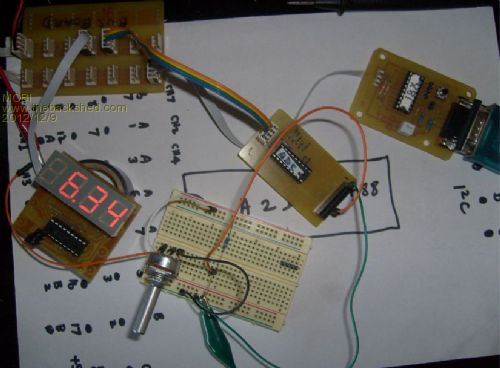

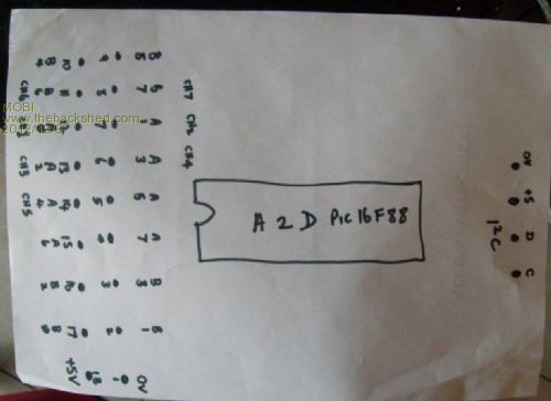

Here is an addition to my picf88 i2c modules.
This is a 7 channel 10 bit adc module. Should be suitable for battery monitoring etc.
It is not continuous read, rather you send the channel you want to read and then read the data on the i2c. I've found it plenty "real time" enough for most purposes.
Don't know if anyone out there is using i2c on TBS or not but here goes anyway.
It is easy enough to drive, just send the channel (1 to 7) out on the control byte and then read the 10 bit code (bytes 0 and 1) - see the zip file attached.
The module is suitable for bread boarding or vero board.
The example shown has a 12 battery across a 10k pot (for variable voltage) and a couple of resistors as a voltage divider to give me reasonable resolution around 0.01 volt/step in the 0 to 50 volt range.
Sorry the pinout sketch is a bit amateurish but I'll do up a proper schematic later.
I use this board as i2c master and various other slave functions from time to time.
Hex file to programme F88 is in zip file as well as picaxe i2c example.
2012-12-09_093658_i2c_adc.zip

Posted: 12:09am 09 Dec 2012
One thought would be if the user could set the reference voltage, so each ADC could have a different reference voltage.(currently reference to v0 i suspect)
Then the chip could be used to read the cell voltages of a battery bank, or perhaps ADC2 = ADC2-ADC1 and ADC3 = ADC3 - (ADC1+ADC2) etc............
It has always been a difficult thing to monitor the individual cells of a battery bank with regards to ground, so could see a good use there.
Although that sounds like a firmware rewrite needed, although it may be of interest to many here to have a I2C module that will allow battery cell logging.
Pete.

[quote]the user could set the reference voltage, so each ADC could have a different reference voltage.[/quote]
As you know, my motto is kiss - besides, it would also take some fancy hardware as there is only one Vref inout point on the pic. That would mean selecting a different reference voltage before each adc read. I don't think there would be enough digital i/o pins left on the F88 to achieve that.
I think the better and easier option would be to rig up an op amp cct (or similar device)to give a 0 to 5v swing for each adc input.
david m
