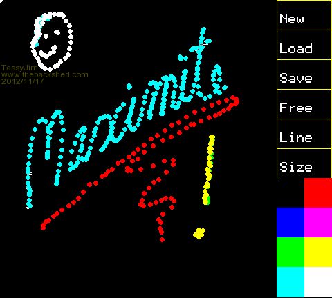

A quick and nasty sketch program to make use of my new touch screen.
My drawing skills are somewhat limited.
(converted from BMP to GIF to upload)
Still needs a lot of work but I am beginning to understand the needs of a touch screen controller.

Posted: 12:23am 17 Nov 2012
Good job TassyJim, look forward to see where you go with this one.

Hi Jim,
I am looking at installing a touch screen for 7" LCD screen with a Duinomite Mega. I saw your program on your thread - Small VGA Monitor and will use your implementation.
Can you share the mmbasic program you used to make the sketch drawing above. I am assuming you wrote the program in mmbasic.

Posted: 01:53pm 17 Jan 2013
This is the program.
You will need to uncomment the call to the calibration subroutine and then change the values for Xslope, Xi, Yslope and Yi.
I found that I needed a resistor in series with the Y axis to keep the current draw down. The X axis at 700 ohms was OK as is.
