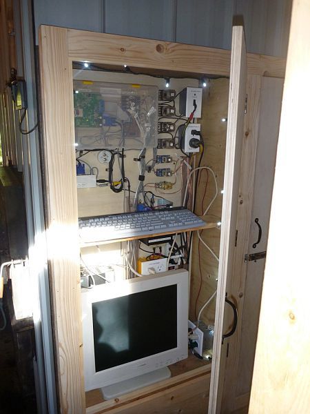

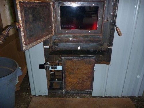

I am using MOSFETS. I mounted them in slot receptacles so I could replace or swap them out if needed. But I don’t know if I can change them for other types of transistors. That is beyond my knowledge or level of understanding at this time.
I like the idea of having a micro switch monitor the actual status of the Air intake plate. I’ll think on that too.
The Air intake is open in the upper photo. Note the plate is lifted by the Air intake motor.
Thanks all! I appreciate all your help.
If any is interested in more pictures let me know. I don't want to waste server space unless it is of interest to others.
PeteEdited by pcaffalldavis 2012-11-18
