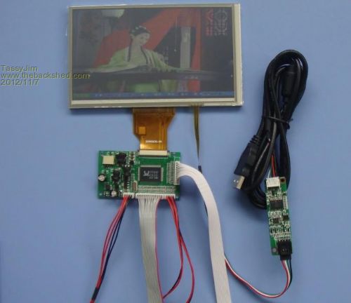

While looking for a suitable small VGA monitor for a project I was tempted by this 7 inch one.
Having the controller separate suits my purpose and I decided to go for the one with touch screen in the hope that I can get it working. I haven't found any details on the touch screen yet but I am forever hopeful.
I will have a month or so to wait for the display to arrive so there is time for more research.
Search EBay for:
VGA+2AV+Remote control Reversing driver board+7inch AT070TN92 800×480 with touch

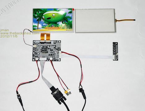

Posted: 12:52pm 07 Nov 2012
Cool find Jim - thanks. The used Liliputt I got from ebay isn't working very well - and I like the "minimalist nature" of the one you found (as well as the price)
UPDATE: If you just search on "HCR-N1" you'll also turn up some other options. This appears to be the name of the VGA input to TFT panel controller board. I think the TFT 60 pin connector for bare TFT panels is standard. If so you could source the panel and the controller separately for even more flexibility (plus possibly scavenge an LCD from an otherwise dead source?)Edited by jdh2550 2012-11-08

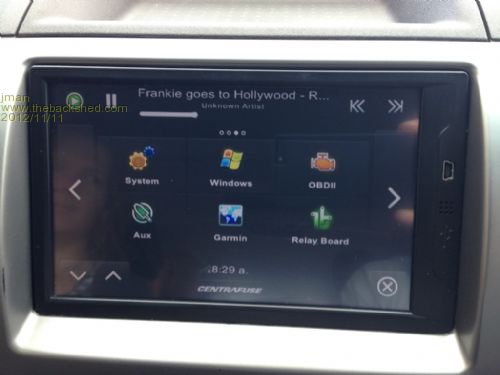

Posted: 09:47am 11 Nov 2012
Hi
Picture of the above monitor installed in my Pathfinder

Posted: 11:20am 14 Nov 2012
John - very nice install. Where did you get the bezel from? Is the USB on the front panel for a USB host connection? What software are you running?
Thanks.
jman
Joined: 12/06/2011
Posts: 711
Posted: 11:53am 14 Nov 2012
Thanks for the kind comments
I got the bezel from here bybyte
The usb is host so I can plugin my iPhone or flash drive in
The Operating system is Windows 7 with Centrafuse as the frontend
Centrafuse makes for a real cool touch friendly system.
Centrafuse
It is also connected the the cars OBDII port so i can see live data from the ECU
The PC itself is mounted under the back set and uses a DC-DC PSU
Lots of hours of setup time
I have also interfaced the steering wheel controls via A/D to USB HID

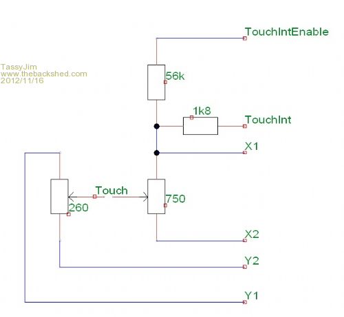

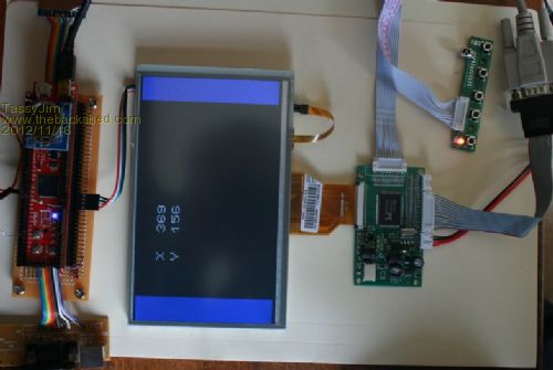

Posted: 10:55pm 15 Nov 2012
My new toy arrived today.
The UBW32 is on the left. I really must get one of Mick's boards for the final installation!
The display works well with the Maximite and I have a rough working touch program.
Only two extra resistors were needed for a low parts count.
I have to do a bit more fine tuning with the timing delays but I am pleased with a first attempt.
See the XPT2046 or ADS7843 data sheets for a good description of how the resistive touch screen works.
How the interrupt works:
TouchIntEnable is set high
Y2 is set low
When the touch contact is made the low resistances of the X and Y resistors pulls TouchInt low.
This triggers the interrupt.
TouchIntEnable is then turned off to prevent it from interfering with the readings.
X1 is driven High and X2 low and the mid point voltage read through Y1. The Y resistance has no effect on the reading due to the high input impedence.
Y1 is then driven high and Y2 low and the Y positoin is read through X1.
The delays are needed because of the high capacitance of the touchscreen and we need settling time.
***EDIT: In my real circuit, I have the Interrupt connected to the Y resistor and grounded X2. The theory is the same and it doesn't matter which way it's done.
' touch display demo
' by TassyJim
' 16 Nov 2012
' see the XPT2046 or ADS7843 data sheets for a description
' of how the resistive touch screen works
cls
TouchY1=37 ' 4 analogue input pins for the resistors
TouchY2=35
TouchX1=38
TouchX2=36
TouchIntEnable=34 ' any digital output pin
TouchInt=28 ' digital interupt pin
gosub _touchEnable
_mainLoop:
'do stuff while waiting for a touch
if t=1 then
font 1, 4
print @(100, 40)"X ";Xhit;" ";@(100, 90)"Y ";Yhit;" "
pause 100
gosub _touchEnable
endif
goto _mainLoop
_touchEnable:
setpin TouchY1, 1
setpin TouchY2, 1
setpin TouchX1, 1
setpin TouchX2, 8
Pin(TouchX2)=0
setpin TouchIntEnable, 8
pin(TouchIntEnable)=1
pause 100
setpin TouchInt, 7, _Touched
t=0
return
_Touched:
pause 5 ' debounce time
if pin(TouchInt)=0 then ' touch still there
setpin TouchInt, 0 ' disable the interupt
setpin TouchIntEnable,0 ' disable the interupt resistor
setpin TouchX1, 8 '
Pin(TouchX1)=1 ' X1 is now high and X2 low
pause 5
Xvolt=pin(TouchY1) ' read the X position using Y1
setpin TouchX1, 1
setpin TouchX2, 1 ' set the X as input
setpin TouchY1, 8 ' and the Y as potential divider
setpin TouchY2, 8
Pin(TouchY1)=1
Pin(TouchY2)=0
pause 5
Yvolt=pin(TouchX1) ' read the Y position using X1
Xhit=int(mm.hres*Xvolt/3.3) ' you can scale to any value here
Yhit=int(mm.vres*Yvolt/3.3)
if Xhit >470 or Yhit < 5 then 'reading is suspect
Xhit=0 ' so set the results to zero
Yhit=0
endif
t=1 ' flag to indicate a touch decoded
endif
ireturn
The next job is to get some working menus
(and work out where in the caravan it is going to live)
